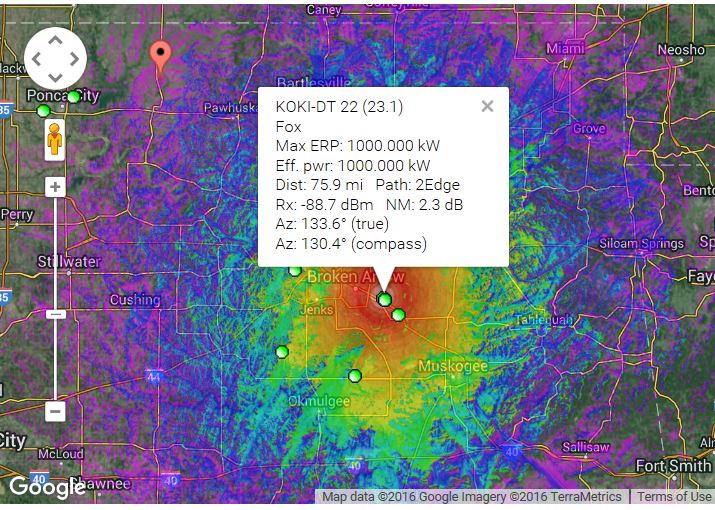

Really I'm just hoping for NBC, CBS and fox.
A Winegard HD7698P aimed at 130 degrees magnetic.
NBC KJRH
CBS KOTV
Fox KOKI
Those networks are also available from 206 deg, but they are weaker and further away.
If a preamp is needed, Channel Master 7778. The 7777 has more gain but it is easily overloaded. The Antennas Direct Juice is also suitable; it doesn't have an FM filter, but I don't think that would be a problem.
I don't know enough about ota and the TV fool charts and 1edge or 2edge and whatever to know what I can or can't get or what I need to do to get them.
2Edge signals can be difficult, and the curvature of the earth at 76 miles is a challenge. You just have to try it.
