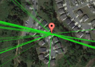

Here is the overhead with the green lines denoting the aiming directions.
Now you can see the aiming directions relative to your homes orientation.
Because your home is new construction, do check for radiant barrier in the attic or Tech Shield shingles as some new building codes to have requirements for energy efficiency.
Thanks ADTech! I will definitely check out for radiant barrier and Tech Shield shingles. Would an antenna recommendation/suggestion depend on if these two things are present in the attic, or can a specific antenna/general antenna type be suggested?

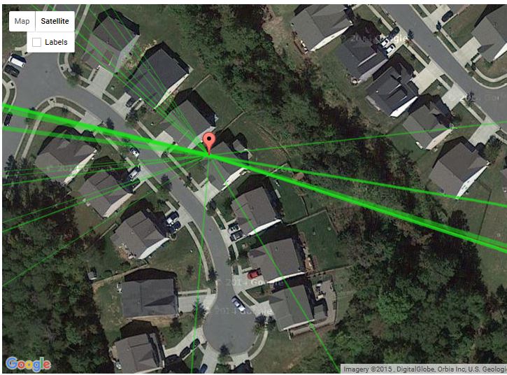

What is really interesting is that the green signal lines clear the other buildings in both major directions.

With the reflector, the antenna is directional. For best results, the antenna must be aimed at the transmitter. See the antenna pattern on page 2:
https://www.antennasdirect.com/cmss_files/attachmentlibrary/Technical%20Data%20PDF's/DB4E-TDS.pdf
When the reflector is removed, the antenna becomes bi-directional, with the major lobes of the pattern 180 degrees apart. What you lose is some gain (~3 dB) that the antenna had when it was directional. The bi-directional pattern looks something like this:

I suggest you try the antenna in the attic without removing the reflector, first aimed at 260 degrees magnetic with a pocket compass not a smart phone compass, with the VHF dipole broadside to 107 degrees magnetic to see how it does. You might need to try different locations in the attic. Then aim it for 115 degrees. You might be happy with 260 without needing to remove the reflector.
What would the tolerance/range in each direction be?
High gain antennas have a narrow beamwidth, so the aim is more critical; that's the tradeoff. Beamwidth is measured at the half-power points, 3 dB down.

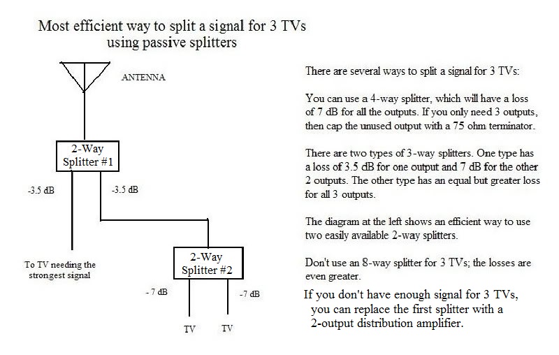

Old 13-Jan-2016, 8:40 PM   #16
My assumption is that the long length to get to the 1st story TV causes the signal strength to attenuate so much that it loses channels.
That sounds correct. Try a Channel Master 3410 just before the splitter in the junction box. How many splits in the existing splitter? The 3410 has only one output, so an alternative would be a 3412 which is a distribution amp and a 2-way splitter combined.
If you need a 3-way split, you can use a 3412 and a 2-way splitter which would allow more signal to the longest run, and less to nearby TVs. If one of your TVs has a signal strength indicator, you can determine how strong a signal must be for reliable reception.
The junction box doesn't have any splitters currently, so I'd need a 2-way splitter.
Is the signal coming out of a 2-way splitter coming out of 1 output of the CM3412 weaker than the signal coming directly out of the other output of the CM3412? Is that how you are saying you could balance signal strength between TV with longer run vs TV with shorter run?

What would be the advantage of going with a distribution amp with a 4 way splitter if I only need 2 outputs?
Sorry, I have confused you with too much information. That would only be for a 3-way split. For the 2-way split, both outputs of the 3412 are equal.
