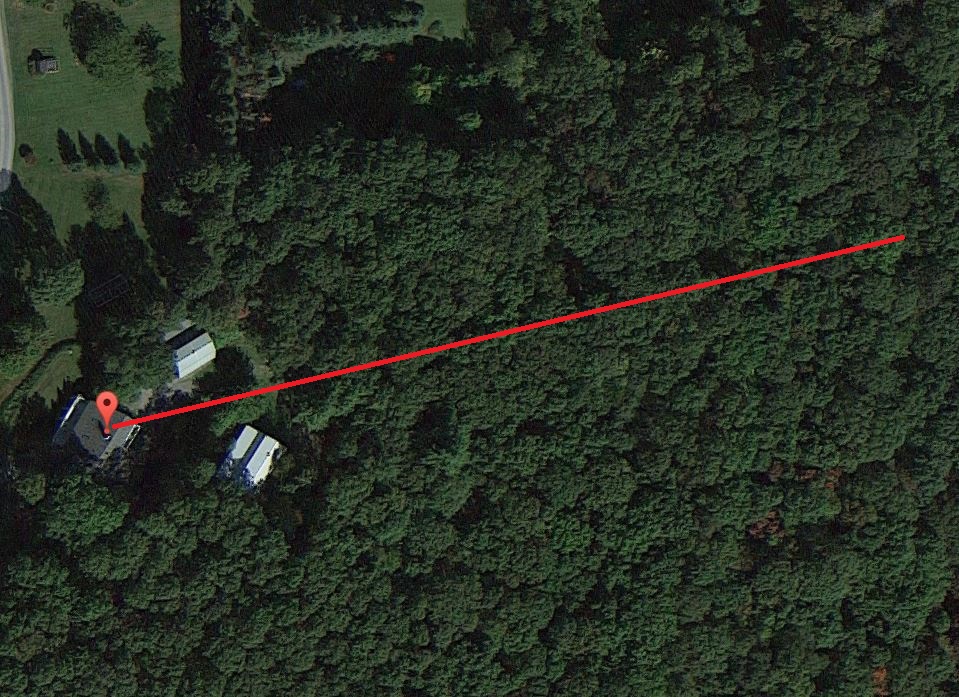

Also, here's a google earth view of where the antenna will be pointed. I'm assuming that the TVfool report accounts for the trees?
Read the bottom of the page under your plot.
"Please understand that this is a simulation and can only be treated as a rough approximation. Reception at your location is affected by many factors such as multipath, antenna gain, receiver sensitivity, buildings, and trees - which are not taken into account. Your mileage may vary."
