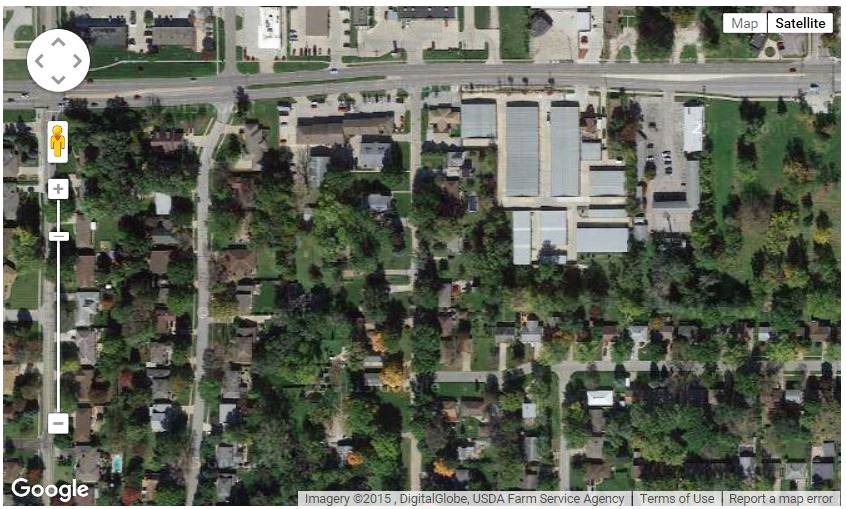

I see a lot of trees in your area. Trees and buildings block signals.
The RCA antenna is a very simple low gain antenna coupled with an amp that tries to make up for its low efficiency. If we can't help you get the RCA going, it will be necessary to upgrade to an antenna that has more gain before the amp.
