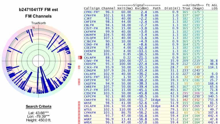

You have some very strong local FM signals that might interfere with TV reception. You will need an FM filter or two in the coax line. See attachment.
You might even need an attenuator because your TV signals are also very strong.
