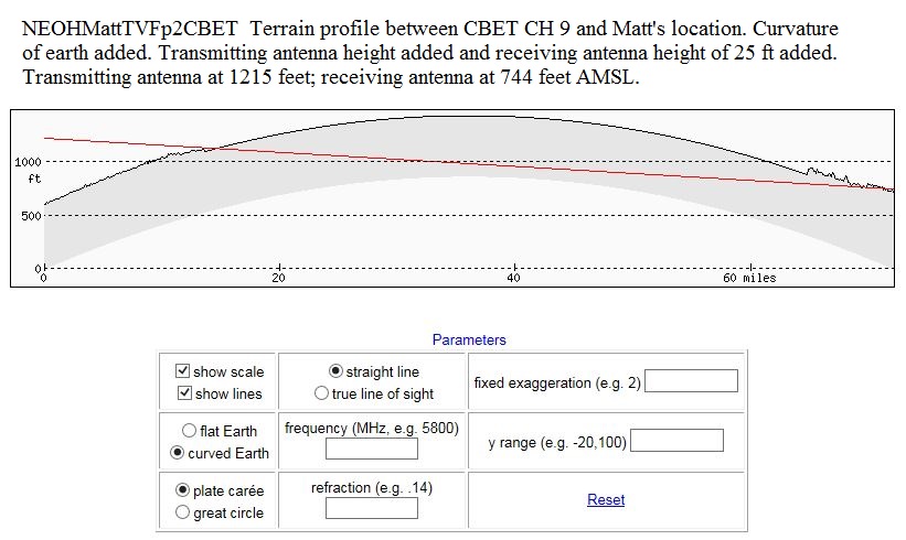

I'd love to be able to pull in CBC (CBET) in addition to the standard US channels, but I don't know if that will be possible since it's pretty far away.
CBET, real channel 9, is a very weak poor quality signal. It is in a different direction and has terrain interference for the signal indicated by 2Edge. You would need a separate high gain antenna and a preamp, but the preamp would be overloaded by your strong local signals.

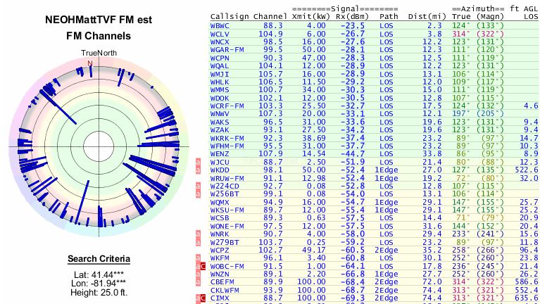

You have some very strong FM signals that might interfere with TV reception. You should inert an FM filter in the coax line. See attachment.

By the time the CBET signal reaches your location, it is almost gone. Notice that only about 5 kW of the max 26 kW of power is sent your way because of the directional pattern of the transmitting antenna:
Just for curiosity you could aim your antenna at CBET 322 magnetic.
The problem is the curvature of the earth that blocks the signal:
