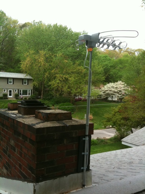

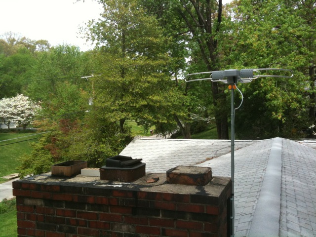

I checked the internals on the Winegard 7694P (once you open the array and snap a small black plastic box with circuit board into postion, that circuit board contains metal coupling pins that clip to 4 antenna feed lines running inside - two UHF and two VHF I suppose) Those appear to be solidly connected.
I do have a metal flue swing cap/door on the chimney, but the antenna is about 3 feet above that. Would the Winegard be affected differently then the LAVA by that cap?
I've attached 2 pictures of the set up - (this is the LAVA - the Winegard was installed in the same location) The compass heading is directly into those trees and at times when I rotate the LAVA toward the front of the house, away from the compass heading reccomended; I pick up a better signal. I do not get that improved signal when pointing the Winegard in that same "off compass heading" direction.

That may mean that the Lava's internal preamp is overloaded, it may mean that the rotor calibration is off, or it may mean that the Lava has a distorted pattern on some channels.
Trees are often a bigger problem on UHF than VHF, so I'd start considering interference on VHF that does not bother UHF. Examples are a noisy computer or power line interference.
You can listed for power line interference using the AM radio in your car. Tune it to 530 and listen for buzzing. If the buzzing is very loud near your house or in the general direction of the VHF TV stations, you may need to have the power company resolve the problem.
