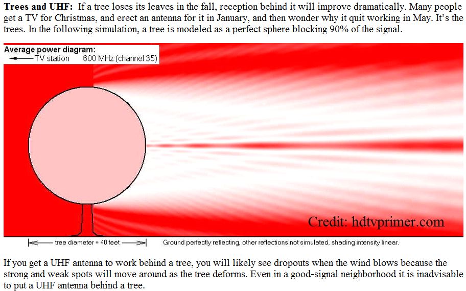

Umm, trees can block signals.
Can you show us what the trees look like in the 227 direction? What does your antenna "see" in that direction?

Well, it's pretty much a wall of mature pine trees that the antenna faces. Just a regular shingle roof, no radiant barrier, solar panels, or inverter. The antenna is on the SW corner, meaning the signal does not have to cross the roof to get to the antenna. I'm sure the amp is something from radio shack, nothing fancy. No power lines for a few miles.
Not good. Is there any way you can set up a temporary antenna that avoids the wall of trees?

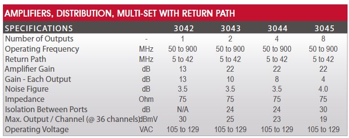

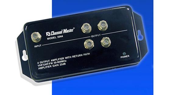

The CM 3044 is an old distribution amp that has a gain of 22 dB, but each of the 4 outputs is only up 8 dB which doesn't compute in today's terms. Must be a high loss split as compared to the CM 3414.
The 3044 specs say max output is 23 dBmV, which is equal to -26 dBm using a conversion factor of 49. That would mean a max input of -34 dBm, if my math is correct. Your strongest signal is -35.1 dBm before adding the antenna gain, so it could be overload.
My impression is that the CM3414 is much less likely to overload than the 3044, but why would you need a distribution amp instead of a passive 4-wqy splitter with signals that strong, unless the trees are attenuating the signals.
My interpretation is that it's a 30 dB amp with an integrated 4-port splitter with about 8 dB insertion loss.
