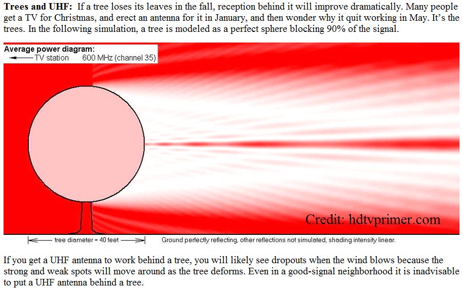

Try to relocate the antenna to avoid the trees as much as possible as ADTech said in post#4; trees block signals.
