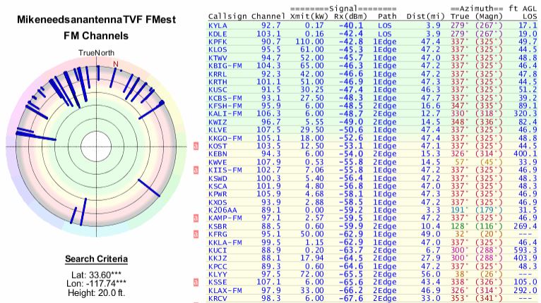

The preamps to consider are the Antennas Direct Juice, Antennas Direct PA-18, Channel Master 7778, and RCA TVPRAMP1R. The Juice doesn't have an FM filter, but I don't see any strong FM signals in your area; see the attachment. The RCA is inexpensive, performs well, and sometimes has a quality control problem, but you can buy 3 for the price of one of the other preamps.
