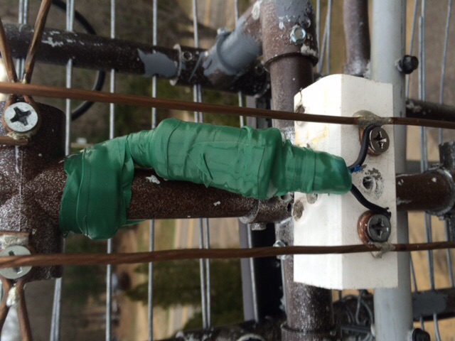

so I still have not settled for a balun I get better signal cutting coax and connecting center too one side and shielding to other side of my bow tie antenna the benefit mostly on uhf med high. I purchased channel master balun and it is a very durable product solid wire instead of stranded leads and sealed well. HOWEVER! It don't work for my uhf mid upper. I purchased 4 of them so I cut leads on one as short as I could with did help (uhf). But no balun works better and my old antique balun works the best. I now will have to order some of the winegard baluns to try. I am close to not using one just not sure how to seal open coax. My mast is not big enough to house a balun. But coax will fit and I would just have cut open coax exposed 2-3" any experience or idea is welcome and thank you for this site

Channel master balun
this is what I went with for my permanent 55' high balun. I cut the lead wires shorter this help picking up my UHF channels the Bollum still did not respond quite as well as a cheap RCA however I won't reach this without renting a lift and the RCA Baumes just do not hold up here in West Michigan I did not try a Winegard it just looked too much like the cheap RCA to me
