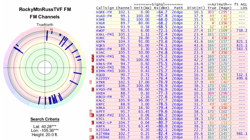

Using the short coordinates on your tvfool report, I don't see any strong FM signals that might cause interference to your TV signals. See the attachment.

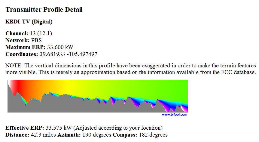

Look at the path the PBS KBDI CH 13 signal must travel. The transmitter is at the left, and your location is at the right:

In order to figure out the best advice I reverse engineered your location. Rabbit73 is right, you need the biggest VHF antenna possible which is the HD7698P. You have little hope receiving the UHF channels from Denver.
The real problem is that the angle up to the hill where the signal is refracted is 21.8 degrees. The best way to accommodate that is to mount the antenna close to the ground with nothing in the way nor in front of it. The exact height will depend on the channel and the amount of downslope in front of the antenna. I'd try heights from 2 feet up to 10 feet.
