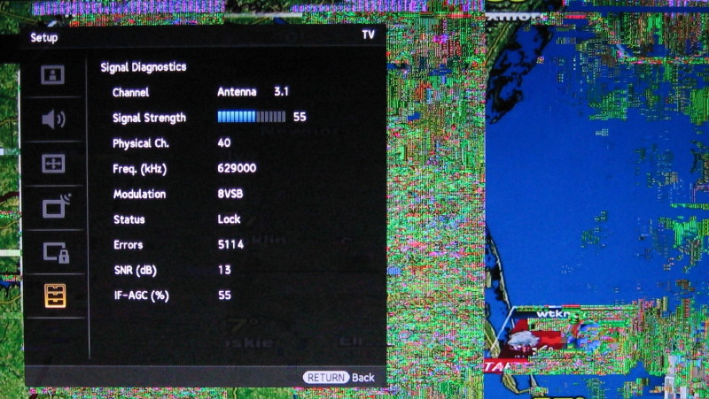

All of the impediments I listed can reduce the signal quality (as defined by SNR and errors), which increases the digital errors in the signal. The FEC (Forward Error Correction) has a limited ability to correct errors. Once that limit is reached, the signal reaches the "Digital Cliff" where you have pixilation, picture freeze, and finally dropout.

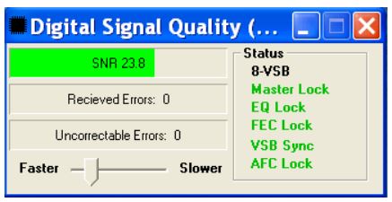

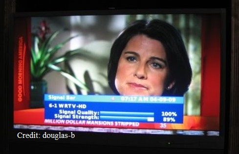

If you are going to continue to do antenna experiments, you really need a way to measure signal strength and signal quality. My first way to do that was with an Apex DT502 converter box that has dual signal bars, one for signal quality and one for signal strength. Cost: a coupon and $10.

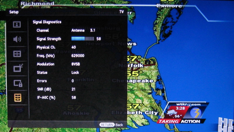

I now use the Diagnostics Screen of my Sony KDL22L5000. Calibration chart in attachment 5.
Bad signal, picture freeze, SNR less than 15 dB and errors:
Good signal:.

Some people use a USB tuner, but the software isn't user friendly for me:
