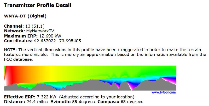

The terrain between the transmitters and his location is causing interference to the signals, hence the 2Edge designation. Can you run a few more exact address (coordinates for greatest accuracy; maybe using the interactive map feature of tvfool that allows you to move the cursor to the antenna location) reports at different heights to see if it would make a difference?
Real channel 13 is the worst; here is its terrain profile. If you click on the callsign in the report, the profile comes up. The transmitter is at the left and his location is at the right:

Thanks for getting back so quickly. The plot I posted was done with the antenna at 0 feet AGL (or I guess null if you dont enter a height) This one is set at 16' AGL. Approx height of where the antenna is now. http://www.tvfool.com/?option=com_wr...f1f0c07554cdfd

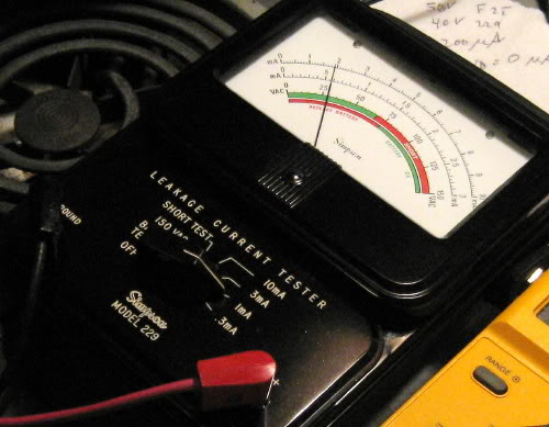

To me, grounding the coax shield with a grounding block connected to the house electrical system ground is of first importance, because it will shunt any equipment leakage current to ground. All AC operated equipment has leakage current, and when operating properly the leakage current will not be felt by most people because it will be below the threshold of perception. I learned about leakage current after I had three close calls from electrical shock; one from my own stupidity, and the other two from other peoples carelessness.
