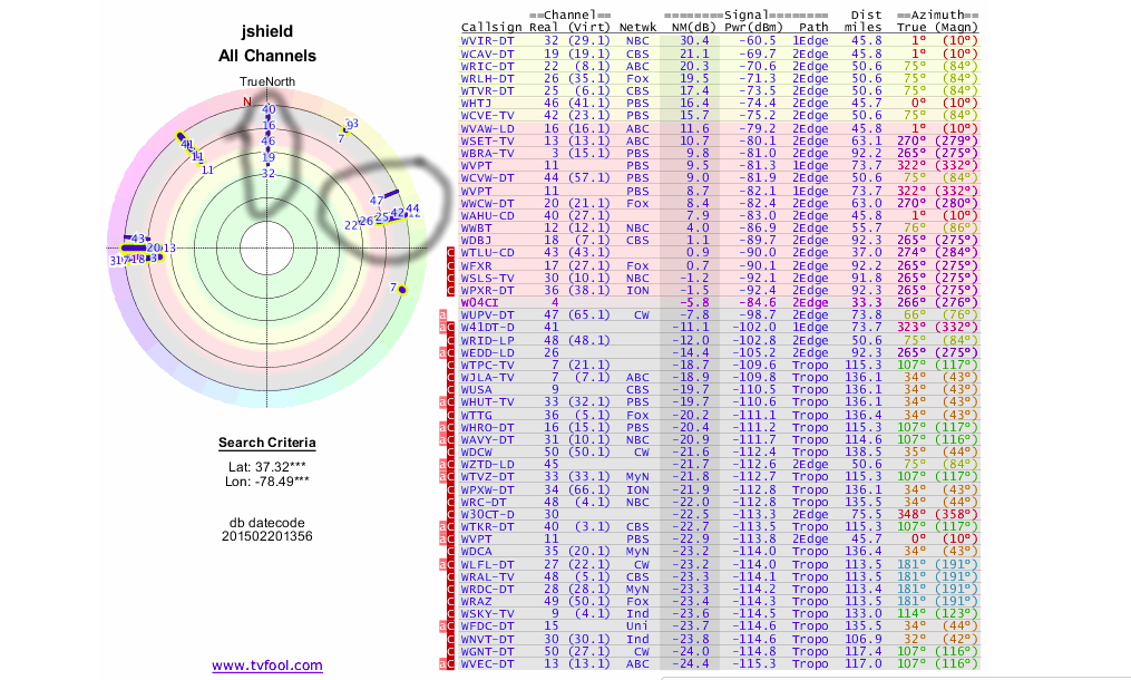

Hello,
I need help choosing an antenna. Any suggestions would be greatly appreciated. Here is a link to my TV signal analysis.
http://www.tvfool.com/?option=com_wr...f1f0da7dab54fe
A clear picture with PBS channel 57.1 is a must have in my case.
Thanks for the help!

Thank you for your help. WCVE-DT could replace WCVW-DT and I would not have a problem with that.
Truly, I would like to get all the channels I circled in the picture I attached. In other words both Charlottesville and Richmond channels. WCVE-DT is more important however.
With that said, it seems to me I would need good multi-directional antenna. I have been looking at the Antenna Direct DB8e. Do you have any input on this?
I plan to attach the antenna to a chimney so I would say 15-20 feet off of the ground. There is two large trees beside the house. One of those trees is in the direct line of sight towards Richmond. Otherwise there is a few acres of field on every side of the house.
