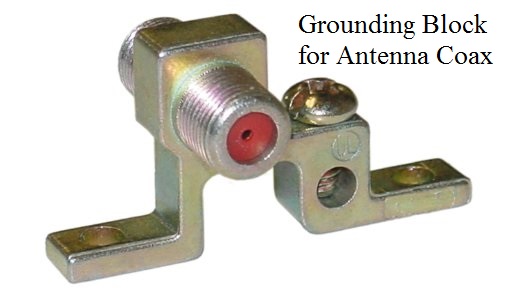

In our apartment, the electrical panel ground wire is connected to the copper water pipe, so I use that pipe for my coax ground. Recent construction now uses some plastic pipes, so you need to check if your cold water pipe is really grounded.
If your cold water pipe is also used as a house electrical system ground, you can connect your coax grounding block wire there. Do not disconnect your house electrical system ground, even for a moment, when connecting your ground wire.
So, to me, the coax ground is the most important. The code also requires a separate ground wire for the mast, which would be difficult for you to do. Dish installers use the "piggy back" method and run a wire from the dish mount to the grounding block; the grounding wire from the grounding block to the house electrical system ground does double duty.

That would be suitable; it can be bare or insulated.

Would I be grounding both mast and coax properly if I came off the mast with #10 ground wire and joined it to the coax ground on the grounding block? The grounding block then grounded to the house ground via #10 solid core wire...
I think you are covered with that method, but as ADTech stated, the local AHJ might say NOT. Electricians in my area say that some inspectors (AHJs) can be arbitrary and unreasonable, but their interpretation is the law and must be followed, or the work will not be approved.
