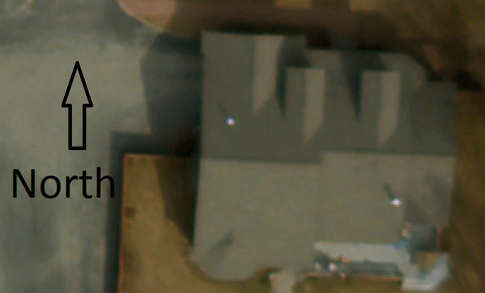

I would like to get CBS and Fox, however, and I'm hoping you guys can point me to antenna that might work. I don't mind replacing the one cheap antenna I bought with one that would work for all if possible. As you will see in the pictures, I can locate the antenna inside the attic either above the garage inside the big red triangle or at the top above the bedroom. I can also probably install one on the outside under the eave, pointing SW, but my wife wont like that. As you can see that wall of the house points almost directly W.
Do you think I can get one to work that is inside the attic space or will I need to install under the eave?

I'd eave mount it at the peak, ON THE OTHER SIDE of the house. Put it up high enough to "see" over the house but low enough that you won't see it from the drive way side, which I assume is the front of the house. And why your wife won't like it there.
Edit;
Looking at your pic labeled north, it looks like you also have another peak in the middle of the roof. That's the same as my roof and where I have my antenna. It' actually the perfect place for it.

As RickBB suggested, I'm going to try and mount one on the second eave on the roof where it wont be noticable, plus this will give me a few more feet of elevation as I will be able to rise up a bit. Would your recommendations still stand for antennas since I can go larger as the wife wont see it? We get a fair amount of wind and snow here in Alaska, so Ill have to have a sturdy as heck mount.
