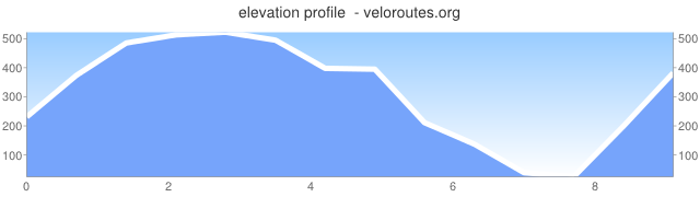

Looking at topographic maps the height of the antenna is ~265 ft. on the line of sight between the house and the transmitting antenna the land slopes from 236ft to around 500ft over 1.5 miles.
Attached is the rough elevation graph (ft on Y axis, miles from house on X axes).

And the transmitting tower base for the stations that I don't receive well is at ~460ft (not including the tower height which is huge...).
