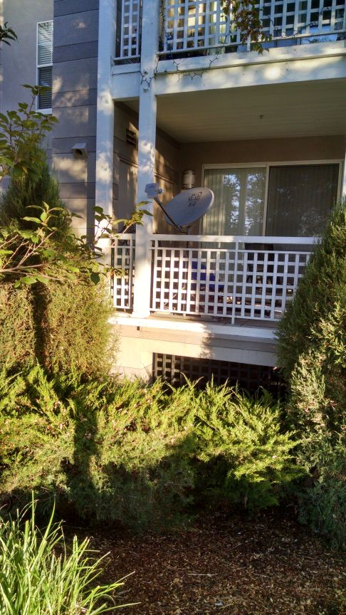

I'm attaching two photos. One shows where my antenna is attached. That is my patio behind it. The second shows a satellite dish. I found a huge number of satellite dishes installed at my building - but all installed in similar ways to this with this strange stand. I suspect I should just find a similar stand and be done with it. Thoughts?

I think this boils down to a question re. 'Exclusive Use' and/or 'Exclusive Control'. If you have either or both of those over the wall surface in question, you likely have the full support of the FCC. If you lack both of those, you will likely want to make nice promptly.

What they're demanding doesn't seem out of line with the OTARD rule, and it doesn't seem (to me) that they're applying it to you differently than to others in the condo building. Keep it within the balcony, don't put any holes in the building, and they'll have nothing to say. It would seem to me, at least. And ballasted flat roof mounts are common.

tomfoolery - am I right in reading this as the antenna cannot stick past the railing? I did notice that everybody's satellite dishes were sticking past the railing (as pictured).
Any suggestions for a mount that might make sense here? I think the sort of flattened tripod style might not be terrible.

I'm not a lawyer, so this is my opinion, and nothing more. There are non-penetrating roof mounts for antennas and sat. dishes, available in lots of places, like this one: http://www.solidsignal.com/pview.asp...-%28frm-166%29 Some are centered, and some are offset, and they come in different sizes. If it were me, I'd use one of them, and stick the antenna over the rail a bit (or not), like the dishes are, but since it's just sitting there, you can always pull it back. With the offset style, and the already asymmetric ANT751r, you can mount it on an offset mount and hang it over the rail, or spin it the other way so the mount is under the antenna and it doesn't go past the rail. Decorate with some big patio pavers (16" square maybe?), and some potted plants, and it doesn't have to look terrible.
