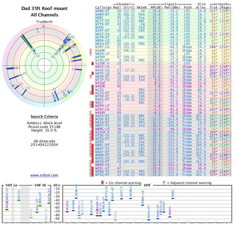

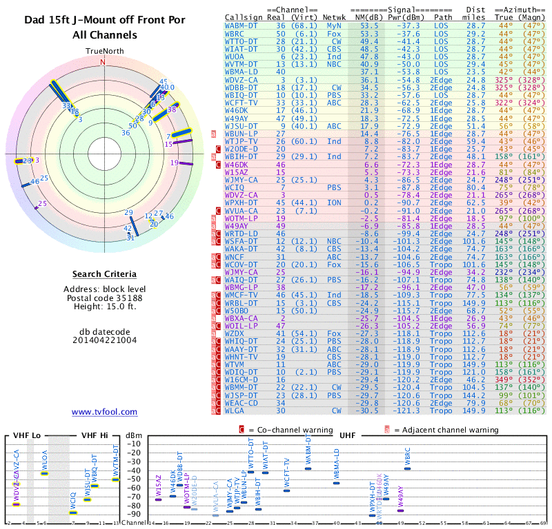

Need some "experts" to point me in the right direction. Attached are images of, and links to TV fool reports.
Situation: My elderly father lives out in the country, 1.5 story house is located on a slightly elevated hill.
Front porch of house looks almost directly to the NORTH. I forsee no multi-path problems like where I live for him. Most all stations are showing as LOS (Light of sight) @44-45 degree heading @ 30 miles out from the transmitters
House is wood frame, with brick exterior. Roof decking is plywood or OSB and asphalt shingles.
There is a "attic" section on 2nd floor on the side of the house facing the transmitters @44-45 that a antenna could be placed. But I doubt that will work due to signal loss.
(Additionally, there "MIGHT" be enough room in the very "UPPER" section of the main roof towards the roof ridge to mount a antenna inside the attic... @ around 25-28ft off the ground)

TVfool report with antenna @ 15ft level
Dad 15 ft J-Mount off front porch 30 miles out
http://www.tvfool.com/?option=com_wr...e1c6d56b2695af
If mounting a antenna in the attic- add a big whopping 5ft
http://www.tvfool.com/?option=com_wr...e1c620517f152e
Roof mounting:
Dad 35ft roof mount 30 miles out
http://www.tvfool.com/?option=com_wr...e1c6ecdd299186
Any thoughts would be appreciated. Hoping a smaller antenna would work off the J-Pole on the North East corner of the house that has a clear shot to the towers, or mounting a antenna in the attic might work but realize higher is better and that shooting thru the roof would reduce signal strength by 50% or so.
File Type: png Dad 15ft J-Mount off front porch 30 miles out.png (136.6 KB, 1060 views)

I'd want to receive WUOA for it's 720P (HD) feed of 'This TV'. That will require an antenna with L-VHF capability. Consider the Winegard HD7084P.

Based upon the numbers you are seeing in the TV fool report, is there any chance antenna's being mounted within the protective shell of the roof would work well?
Roof=Conventional construction, 2x8 joists, plywood or OSB decking, asphalt shingles.
(50% in signal reduction, right?)

50% signal strength reduction , Tv antenna in the attic , is the target number , can be more , can be less.
There is also the interference and multi-path issues in the attic.
--->The Only Way<---to Discover what the Reception is like in the Attic is to Install the Antennas in the Attic.
