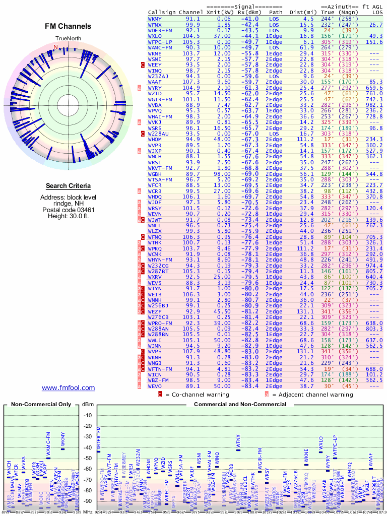

Some of my good reception channels have Pixelization, I have attached my FM report with my TV Fool Report, it looks like my FM reception may be interfering with my TV reception, what do you think? I do not have a FM filter in my cable line, would this help to put one in?

Probably not, but it might be possible that your FM signals are causing interference to your TV signals since they are 30 to 40 dB stronger than your weak TV signals. Why don't you try an FM filter.

I had that happen on one channel. slight antenna adjustment fixed it.
