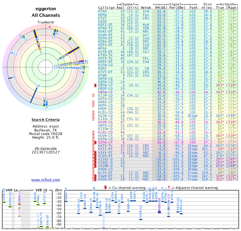

my antenna is a bu-22 Antenna Craft and is 25 feet above the ground. I am confused about what direction I should be pointing the antenna. do I need an amplifier? Do I need to merge 2 antennas?

From Burleson, aim the antenna due east then back to the left about 10°. The front of the antenna is the narrow section.
No, you likely don't need an amp and you shouldn't need to merge two antennas.
Just hook it up with a temporary RG6 coax to start with, then follow the TV set or converter box owner's manual to program it for reception.

Based on the provide picture of a Tvfool report not a live Tvfool report.
Aim the antenna at about 90 degrees magnetic compass direction , East.
Here is how to aim antennas , www.kyes.com/antenna/pointing/pointing.html .
Use a Real and Actual magnetic compass to aim antenna.

thanks for the help that did the trick I had it for 180 degrees in the opposite direction now I have really good signal on all channels thanks for the help again
