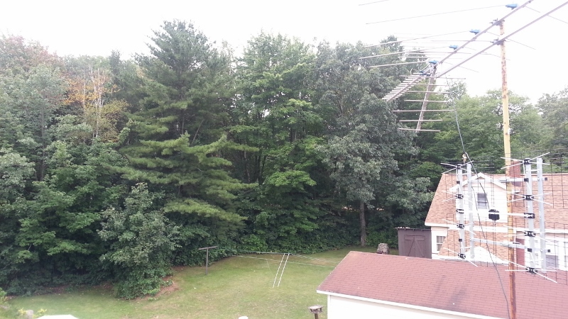

This is what it looks like looking SW from my rooftop.

If you where seeing WLUC intermittently, I'd feel no guilt suggesting you try a another UHF antenna.
Given you don't see WLUC at all with the DB8, I'd be looking for ways to go higher. But then I used to get paid for working on a tower and I still like climbing.

Would the deterioration in reception coincide with the leafs on the trees coming on and maturing?
Old 10-Sep-2013, 3:27 AM   #9
RedBull1973
Join Date: Sep 2013
Posts: 11
It may be the leaves, but those have been there all summer. It was in the last week when I was able to snag 35 for a short while. I think it may have came in when I was testing out an RCA TVPRAMP1R preamp with only the old antenna up there. I do have an Antennacraft 10G202 preamp coming in tomorrow and will try that. That seems to have descent reviews with high gain and low noise so I'll see if it's a keeper or not. I don't have many problems with 10 and 13 though, which they are higher power.
Want to know the funny part here? The TV station is actually located right across the highway from me...about 1/4 mile or so. They put their transmitter in a higher elevation about 20 miles WSW of the "big city," and there are numerous elevation drop-offs between the two. Fortunately, things don't really drop off until a mile or two East of me.
