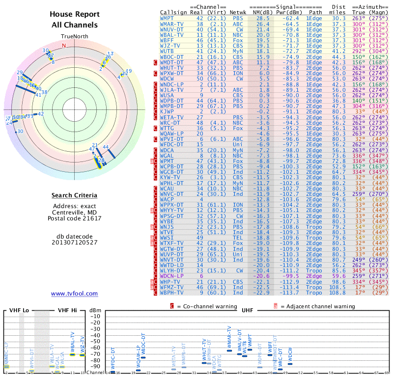

TV Fool report attached
I've attached the report. Thank you for the reply.

The provided tvfool report is the default 10 feet antenna height above ground.
To see is signal strengths improve with higher antenna height please provide a tvfool radar report with a antenna height of 25 feet above ground.
25 feet above ground is a reference antenna height that provides a good idea of what is receivable.
Like the other Question Askers do.
Please provide a Live and Active tvfool radar report , not a picture of a tvfool report.
Do not delete the picture of the tvfool radar report.

Ok, I'm following you now. I think you guys want to see this:
http://www.tvfool.com/?option=com_wr...46aed73825feae
So again the issue is that one TV gets 38 channels and the two others get an average of 8. All are using just the internal TV tuner. No receivers or converter boxes or whatever.

Your testing suggests that the tuner getting 38 programs is a superior quality tuner. Member tripelo has posted the results of their side by side comparison of several SD converter boxes. http://forum.tvfool.com/showthread.php?t=13236&page=4 post 67.
Channel Master and Epivision are a couple of names that come to mind when HD converter options are needed.
Have you tried testing the performance of the antenna outside, clear of obstructions?
