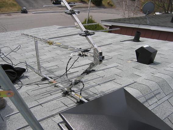

Hi guys,
I just installed my hd stacker from Dennys on monday. Its been raining like crazy all week and overcast and ive been receiving Fox and CBS and 3 pbs stations from the states 100+miles away from me. Im looking forward to when the sky clears up to really test this baby out.
The antenna is installed on a 5 foot tripod and a 7 foot galvanized mast and 3 foot rotor mast on my roof on a 2 story house. im in Aylmer Quebec Canada :-)

good Morning Billiam,
To be honest with you its been raining like crazy ever since i installed it but this past weekend was clear and sunny. Last night after the kids were put to bed i started to play with the rotor and i pulled in 57.1 .2 .3 from Plattsburg NY those are Mountainlake pbs , that was the 1st time that i turned the antenna that way. also on saturday night i scanned in 7.1 .2 .3
PBS from Watertown, then fox and cbs ABC and CW from watertown also.
The constant american channels that i get even in the rain is PBS 18.1 .2 .3
and Fox and CBS 28.1 .2 but i havent had time to focus on the mountain lake region, ill try later tonight to get a better angle to see if i can get it even in the rain and overcast.
I attached a few pictures for you

I tried a HD Stacker here last Summer and compared it to a YA 1713 from Winegard on Ch. 7. At that time I had the antenna mounted ten feet off my roof and the coax was running into a Channel Master 7777 Titan Pre Amp. The YA 1713 was a little bit better than the Stacker since at that time it gave me a stable albeit weak picture on Ch. 7. Since that time the single YA 1713 developed the same signal dropout and in the Fall I added a second YA 1713 and coupled them properly and phased the cables per the instructions of a Winegard Tech. Unfortunately I now have seen another drop in signal strength and to add insult to injury it now appears as though a co channel in another city around 150 miles from here is also impacting my signal.
My options seem to be to try to use a horizontal coupling of the two existing YA 1713's and hope that solves the problem. Or to use a single antenna with more gain and perhaps more interference rejection capability but mount it a few feet higher than the present 15 feet. I can't get the existing unit any higher or even a horizontal gang either with the mounting surface that I have.
First, I will likely try a single all channel antenna with higher gain than the YA 1713's to see if that solves my problem on Ch. 7. If not, then I will have to try the horizontal gang and see if that works.
I'll be interested to see if you can get Ch. 7 from Watertown most of the time during the day or the better part of a 24 hour day, every day.
The HD Stacker is a good antenna by all accounts. I had not tried the UHF section but I am certain it works quite well. I've seen a lot of favorable reviews of this antenna and my own experience showed it worked nearly as well as the YA 1713 on Ch. 7. But now I may be able to overcome the slight deficiency in the gain of the Stacker by moving it higher and eliminating the need for a UHF separate as well. It will certainly look better than the current mess on my roof. :-)
