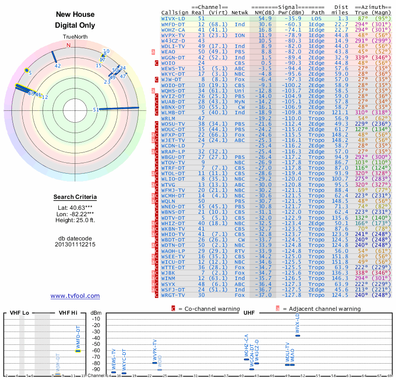

Hello everyone first post here, just looking for some advice and guidance. I have attached my tvfool report to help get a sense of equipment to purchase for my location. There is currently no antenna equipment at the house, using RoadRunner for internet that we will keep. Plan to install new RG6 quad for new antenna installation. Here is my tvfool signal analysis I have also attached the image, just in case the link does not work.
http://www.tvfool.com/?option=com_wr...1ddaaaaa5d73ca
I know it may be a long shot to get a lot of channels due to our distance from major cities. I am primarily concerned with receiving WEWS, WKYC, WJW, and WOIO if possible but the more the merrier. Not sure if an attic mount would work for our location, it is split level ranch home with composite shingle roof. From the back of the house roughly points in the direction of these transmitters with a clear line of sight if roof mounted, and opens into a field. I plan on purchasing a HD Home run, just unsure on other equipment and really the best solution for antenna and location. I would like to provide signal to 3 televisions, 2 large lcds, and a smaller lcd tv. Any help would be greatly appreciated as far as amps, antenna, splitter, and any other equipment you would recommend. Thanks in advance.

WOIO , CBS and Me-Tv.
WEWS , ABC and LWN Live Well Network.
WKYC , NBC and Weather/News.
WJW , FOX and Antenna Tv.
Are the only receivable , CBS , ABC , NBC , FOX , Tv stations at your location.
The Signal Strengths are Very Weak.
To reach out for these And The Other Tv stations/channels to the north east.
Install Above the Peak of the Roof in such a manner that reception is not blocked by the roof and house in the directions of , north east , east , west north.
Install a Winegard HD7698P antenna aimed at about 35 degree magnetic compass direction.

Tv stations of other directions then north east.
Are at angles to the HD7698P antenna , this reduces the ability of the HD7698P antenna to receive the Tv stations.
Tv antennas receive the best at the front of the antenna , and less reception at angles , back and sides of the antenna.
_____
WIVX , has several different digital sub channels , is very strong signal strength and will be received by the HD7698P antenna.
WMFD , Independent Tv station is strong signal strength and will most likely be received by the HD7698P antenna.
WOHZ , Infomerical channel is weaker signal strength and may or may not be received by the HD7698P antenna.
W43CZ , is OHIO PBS and is weaker signal strength and may or may not be received by the HD7698P antenna.
W43CZ OHIO PBS is not the same as WEAO Western Reserve OHIO PBS.
