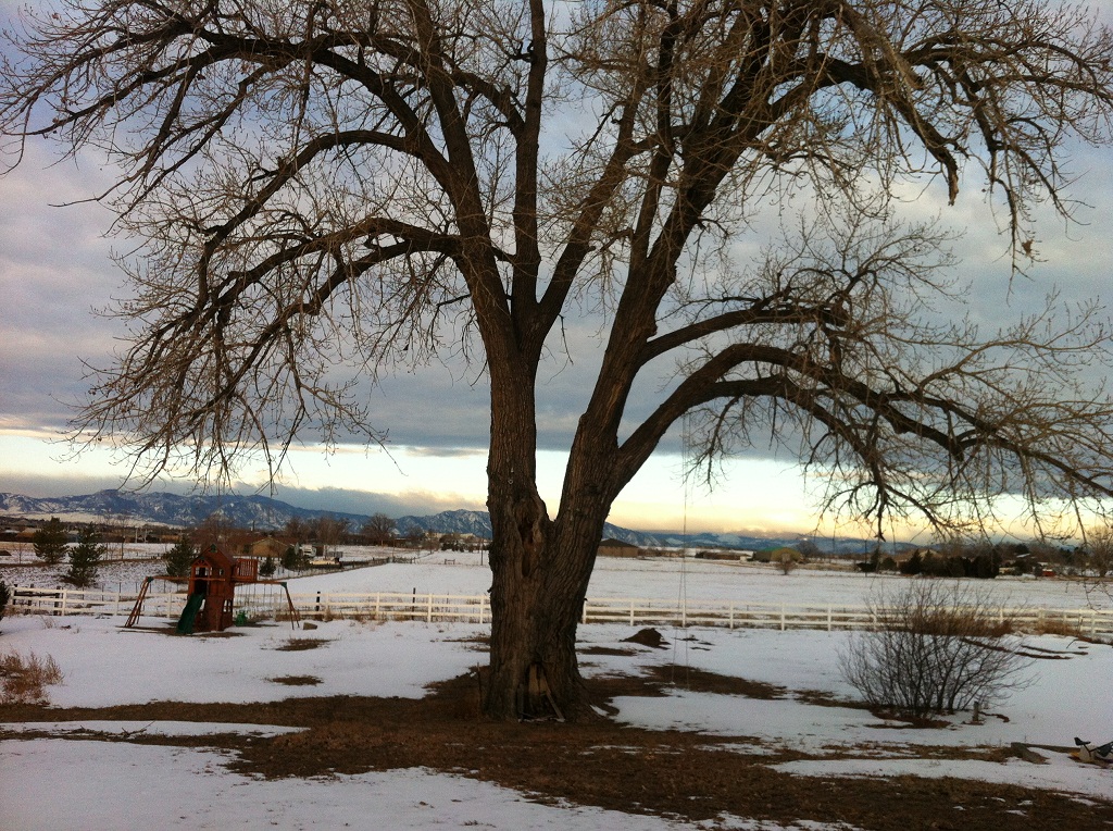

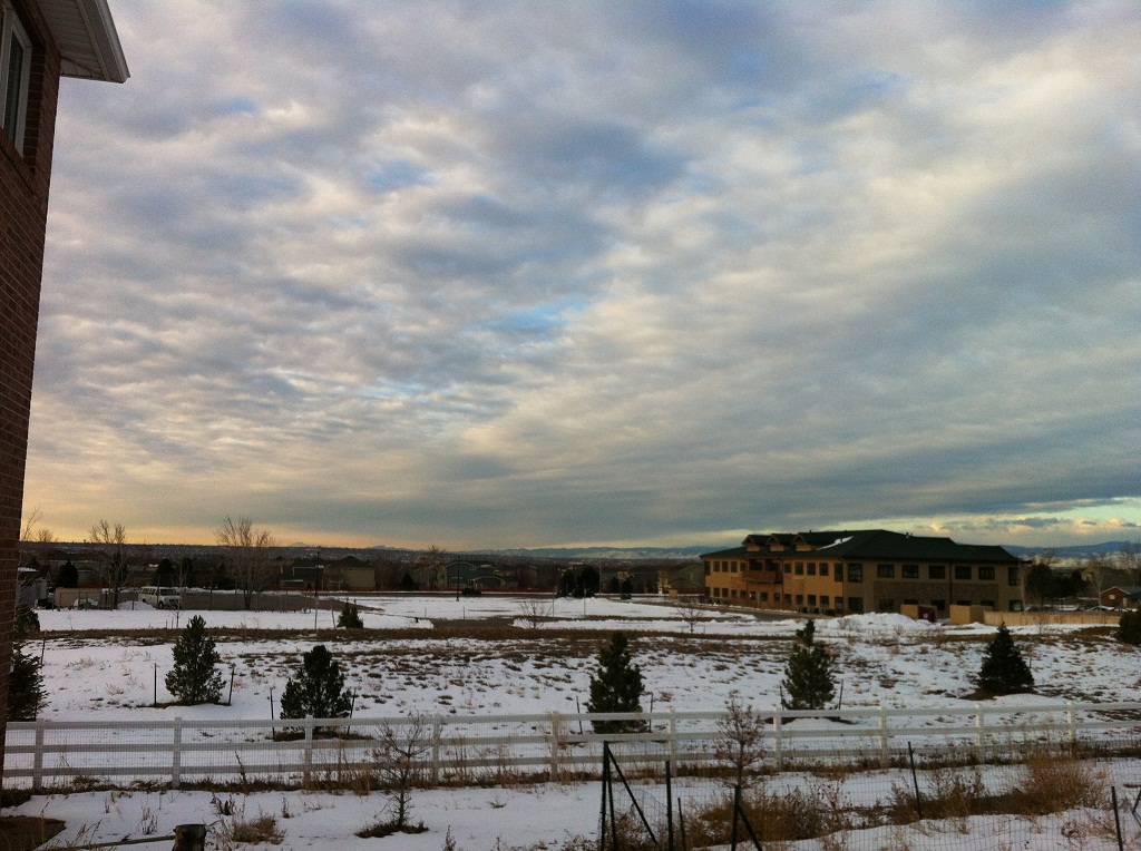

Here are some pictures I snapped of the landscape. Looking due South is the first pic & it is clear.
The only issue is looking due west I have a very large tree that will block some coverage.

The U8000 will work Ok.
A Winegard HD7000R will receive as good or better , and requires no modification.
Aim the HD7000R at about 200 degree magnetic compass direction.
Install the antenna Up High so that reception is not blocked buy the roof and house in all directions.
Use a Channel Master CM3410 distribution amplifier and a 6 Way Splitter.
