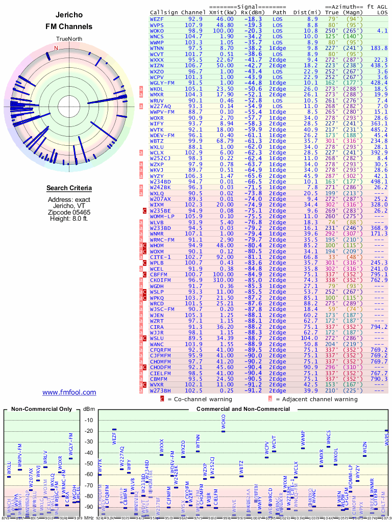

While this might sound close to impossible, I currently have a Winegard HD-6000 FM antenna pointed at the same tower set, and can get the following FM radio stations with some minimal static on a bad day, and on a good day they're clear with a slight FM stereo hiss. The HD-6000 says it's a 5dB gain antenna.
The reference FM stations are: CJFM and CKOI FM. I can receive the others, too, but do not listen to them.

Realized that my FM Fool link doesn't work. Here's the image file.
