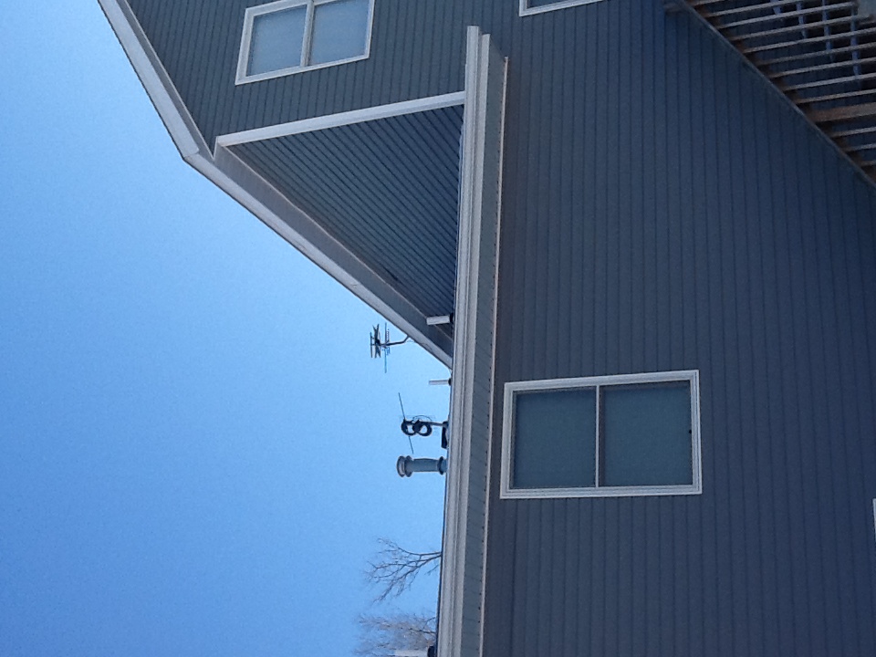

The antenna is aimed towards Springfield/Bolivar. I've attached some pictures of the antenna so hopefully someone can identify the model. Anyway, here are the pics.

I hate to say it, but if the guy sold that as a "100 mile antenna", he lives in an alternate universe where a mile is much, much shorter than ours. I don't recognize it off-hand and I cannot make out enough details to do so, but it would appear to be a small UHF/VHF compact combo.

Well, that antenna, for starters, is an unknown. It obviously isn't what you believe it to be.
You say you have a preamp and a distribution amp. Which ones? How are all of the system components connected?

Sure, the image is way to distant. Use your zoom on your camera to take a up close picture of the design.
Plus, the 100 mile claim is just unscrupulous advertising in these cases. Small amplified plastic antennas don't do "150 miles" either. It's garbage.
You want to talk what a 100 mile (VHF) antenna looks like? Go look at the old Channel Master Quantum 1160. It's almost 16 feet long. Most advertisers don't go beyond 70 miles with UHF claims because curvature of the earth combined with the shorter UHF wavelength makes those signals degrade faster than VHF counterparts.
As to your questions about FOX and specifically if you are out of luck. Not at all, according to your plot I would think your clearstream 2V ought to receive KRBK at a heading of magnetic 349. Where are you pointing the clearstream? Have you tested alternate locations on your roof? Sometimes moving a few inches to a few feet can cure a "dead spots."
It's too bad I didn't see your prior posts. I might of suggested an Antenna's Direct DB8 mounted on a rotor with an option for an Antennacraft Y5-7-13 if KOLR was unreliable.

I see the ClearStream 2 V , CS2V , CS2V UHF/VHF antenna , in the back ground above the roof in the pictures.
Is the , CS2V , receiving , KRBK UHF Channel 49 , FOX??
And what approximate direction is the , CS2V , antenna aimed??
Yeah I should have known that 100 mile claim was bogus. How I even ended up with that second antenna was because he couldn't find FOX KRBK with the Clearstream 2V but he didn't use a compass to help him aim either. That antenna is aimed toward Fordland, MO. He brought back the "100 mile antenna", some sort of preamp, and distribution amp to get FOX. I had better pictures with my regular camera but they couldn't be uploaded because the files were too large.
So are you saying you think I can pick up the Fox KRBK stronger by adjusting the aim of the Clearstream 2V to magnetic 349 degrees and still maintain strong signals for the other major local networks? If so is that with or without a preamp? I've emailed the installer to ask what the model numbers are on the second antenna, preamp, and distribution amp but haven't heard back. I wish I had additional options for installation/modifications if indeed it looks like I can strengthen the Fox signal somehow. I'm not "handy" enough to do the necessary adjustments myself I'm afraid.
Did he do a channels scan after each adjustment as well? With green shaded signals and line of sight, you may get away with not pointing the antenna at the transmitter (known as off axis) and still see a signal reliably. With FOX KRBK, you have 2 edge conditions and about 32 db of strength. Still, not a terrible signal, but 2-edge conditions can cause problems. You are literally receiving signals through impediments. Thus, with these signals that are terrain blocked and weaker, you need to have your antenna facing them to have the best chance at reception. Or you may have odd multipath. You just have to get in there and test it.
I don't know your runs of coax, but with 65 db strong signals in the air I'm surprised you see anything at all if you are pointed at them. Preamps and strong green signals generally don't mix. It is recipe for overloading, meaning, your tuner is getting much signal and it overwhelms it and degrading reception. The weaker signals are normally the first ones to go. Perhaps take the preamp out of line and do a rescan. This includes the connection to the coax at the preamp and remove the power supply within your home. You want your antenna to have direct coax into the TV with nothing inbetween. You may notice Fox may appear. I know when I tried to run a preamp on my RCA ANT751 with 65 db signals in the air, a 17 db signal which I enjoy disappeared. I removed the preamp, it reappeared. Test that would be a suggestion. [/quote]
I think the clearstream 2V is enough antenna to receive KRBK at magnetic 349, yes. Your station clusters are a 50 degrees magnetic and 349. You will lose signal of the one you aren't pointing at. You may still see them, but they will be weakened as they are off axis. You'll just have to try and experiment and find a sweetspot. If you can't, a two antenna option may be needed. One thing is certain though, you need your better antenna pointing at 349 for KRBK.
Do you have an A/B Switch? How are both antennas in line?
Disconnect preamp and run direct coax into the back of your TV on the clearstream 2V. My gut feeling unless you are running long runs of coax, a preamp is likely not needed by you. Orientate to magnetic 349 and run a channel scan. You'll know pretty fast.
You have a distribution amp? How many splits are you doing?
Generally when antennas are set up, you run one lead of coax into one TV. determine the antenna is aimed right and receiving the signal in question properly. Then you can start installing the system piece by piece so you know at what step a problem crops up.
Perhaps you need to find an installer that is a little more ethical. We can talk you through a set up, but someone has to be on the ground to test, re-test and work out the problems.

Can a J-mount be used for the 42XG or 91X? If so, what size? If not, what am I looking at? I am supposed to have someone coming out on Thursday, so I am trying to find the equipment needed on amazon since as a prime member I can get it here in time.
If I can receive the signal with the 42XG or 91X, do you think the signal will be strong enough to watch before the custom combiner comes in?
Do you feel like the preamp being used is good for my situation or should I consider a replacement? Thanks again.
mulliganman is offline   Reply With Quote
Old 28-Jan-2014, 6:17 PM   #19
is this the correct amplifier
Yes. Check first to see if you actually need a distribution amplifier. Your TVFool plot says "No".
Yes. The antennas will mechanically fit on either our 30 or 40" J-mounts or any other mount 2" or less in diameter Keep in mind that additional antenna height may be needed (see above) and the J-mounts should not be extended without reinforcement or guys. Have the installer test reception of KRBK first using a temporary mounting facility before drilling any holes.
Probably, if you can get the signal to come in at all. Your location is not simple.
It's probably okay. I'm not a fan of that pre-amp due to several reasons but it works well enough for most folks.
I would make the antenna/pre-amp work first, then consider the purchase of the AC-7 combiner. Otherwise, you'll drop $150 or so on something you can't return and still cannot use.
Your signals from Fordland, might, in fact be strong enough to come in on the 91XG anyway. Test it before committing to the combining exercise.

Got both the 42XG and 91XG on order for delivery tomorrow. I'm not sure yet which to try.
Also have the Channel Master distribution amp on the way in case it is needed (although I'm not sure how to know precisely if it is needed).
I know you said the Wineguard HDP269 preamp is probably okay, but if you had another suggestion what would it be?
I will report back my results. Thanks again ADTech for the input and suggestions.
