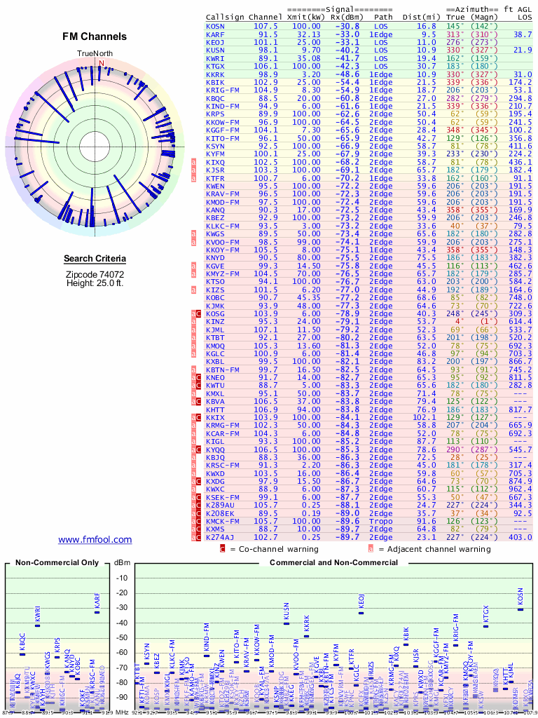

I am planning on hooking up to just one receiver using 70ft. of rg-6 since the receiver calls out for 75 ohms. My report should be attached, KMOD_FM is what im shooting for. I made the antenna from an old tv antenna using the two elements that were closest to the middle of the FM radio band. Not sure if I will need some matching between the coax and the antenna. I have yet to solder the rg-6 to the antenna. Looks like the report shows it should be hitting the elements at around -72.4dbm. I looked up the loss on the rg-6 for 97Mhz and looks like it will be a little less than 2 db for 70ft.
Im planning on using a SVI amp. If im on the right track, Im thinking the 15db should raise the -72.4dbm to 14.928db, subtracting the 2db for the rg-6, should leave me with approx 12.928 db to the receiver as long as there are no matching problems or unforseen losses elsewhere.
Am I tracking this or am I missing something?

I think you're estimate of loss is about right. However, decibels are added, not multiplied. If you deliver -72.4 dBm to the antenna and it has 3 dB gain, you should expect -69.4 dBm at the antenna terminals. If you deliver -69.4 dBm to the input of a 15 dB gain amplifier, -54.4 dBm would be the expected output. After traveling through coax with 2 dB loss, the power to the tuner input would be -56.4 dBm.
