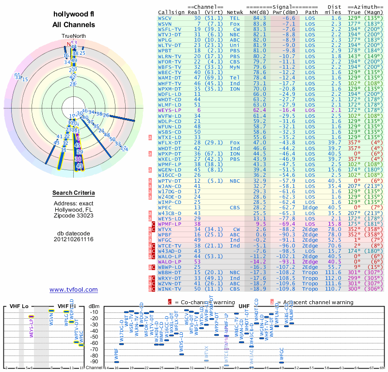

this one? sorry im new here
http://www.tvfool.com/?option=com_wr...cc49a8f01f3e0e

You have many signals available to you. The challenge is that the transmitters are very close which results in too much signal strength. Use of 20 to 50 dB of attenuation may be needed.
You need to resist the temptation to use any sort of amplifier... external or built in to the antenna. Simply unplugging power from an amplifier is not enough, the amplifier must not be in the system at all. A Terk HDTVi (not the HDTVa) would be an option. You could also opt for an RCA ANT-751 possibly in the attic or outside... In any case you may need to add attenuation between the antenna and TV.

radar report is exactly address
this report is like last one but now with 25 feet antenna.

Most of the Digital Broadcast Tv stations/channels at your location are less then 3 miles away and are - Over the Top Strong Signal Strength - at your location.
The Tv transmissions are so over the top strong that the first 12 of the tvfool channel list are high lighted Red.
DO NOT use any type or kind of amplified antenna or preamp or distribution amplifier , non , zip , zero and zilch.
