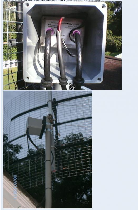

meridish
Join Date: Nov 2011
Posts: 31
Originally Posted by bjs81 View Post
Well after you all have educated me about pre-amps and how they only need to make up for the signal loss between the antenna and the tv, wouldnt the KT-100 be a better choice, especially seeing how it is adjustable. Then I can adjust it perfectly to my system. But will I need a meter of some sorts to measure the signal at my TV, or how does that work? And do you have a suggestion for a weather proof box for it to be mounted in up on the antenna? Or I could install it in the basement after 37ft of coax from the antenna if you feel my loss of 2.22 db will not be bad enough to loose channels. Remember though, I have really weak signals to begin with?? please advise me of my next steps. Thanks, Brian
Please see the picture for an idea how to weatherproof kitztech.
Thanks
Eaglestar 53-6165-1V-L, Kiztech-200 in the Attic
meridish is offline   Reply With Quote

Home Depot usually stocks PVC junction boxes with rain tight covers. Kudos to meridish for posting the photos of the type of box I was thinking of.
