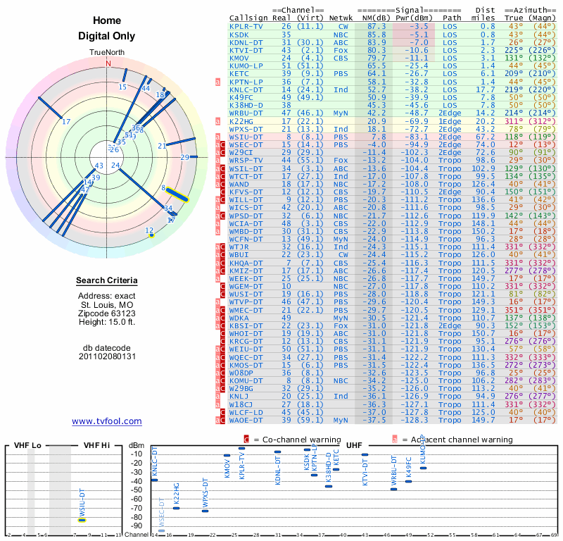

Hey All- nice site and I'm hoping I can get some help.
My digital channels are very close and all around me. I've attached my spec's. I'm only interested with the networks in green.
Thanks again for your advise.
Z
PS: I'm wanting to combine signal with satellite cable and feed 2 TV's trough satellite tuner (Dish)

One thing's for sure, do not use any type of amplifier!
A simple, $5 bowtie from Radio Shack could do the trick, since I see no VHF channels near you.

Yes I agree a variable attenuator. At http://www.solidsignal.com , the 1296F . . The transmissions are so strong that I recommend dialing them down. One of these simple antennas will work fine. http://forum.tvfool.com/showthread.php?t=233 . . Here is how to point Tv antennas , http://www.kyes.com/antenna/pointing/pointing.html The transmissions are so strong that first ones are highlighted with red. And rest are over the top strong.

If the omni antenna you have has an amplifier or does not have a amplifier , then do the antenna favor , get shotgun and put it out of it's misery. . Omni directional tv antennas Do Not reject multipath. Multipath is signal reflections bouncing off of , in your case -- everything and the multipath bouncing signal are super strong. The digital tv tuner has multipath correction , however in your situation there so much multipath and the signals are so strong that the digital tuner is overwelmend.
