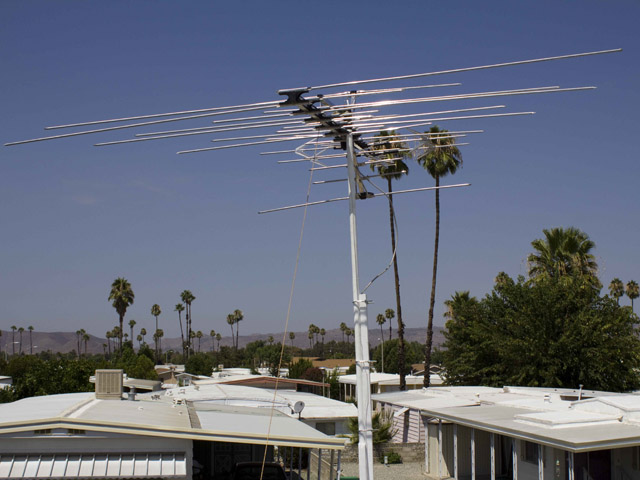

Now I am getting reception of most channels out of LA on my Winegard HD7084 High Definition VHF/UHF Antenna. Signal strength on my Panasonic GT50 Plasma varies from a high of 86% down to 14% and even zero. When I fall below 40% on some channels and mid thirties on others it will start to break up then seriously and completly drop out when it drops to the 20s and teens.
This has all been great given that I was advised I would only get a few channels and not all the time on those at this 70 mile distance.
When I was watching the Olympics it would drop out intermittently on channel 4. This would happen at completly random times both day and night with early evening being more and more intense drop outs. These would last from seconds to a several minutes. Channel 13 would also drop out with 4. Rarely channel 2 would fail during that time and when it did channel 4 would usually show strong signal with occasional drops. This reception pattern was consistent in both sunny, windy and rainy weather and at night.
Recently we have had a cooling trend here in the Southern Calif region. Also the days are getting shorter and I notice that I get more drop outs and loss of channels in the evening hours lasting till after sunset. Last night, the 24th of August was the worst. I lost 2, 4 while 7 came in strong. I had 11, can't remember if 9 and 13 came in but I also had drop outs in the PBS channels 22, 24, 28 and 30 which has been rare. Another odd thing has been that when 2, 4 and 7 have strong signals the UHF channels are weaker signals and vice versa.
Bottom line, currently I can watch most channels just fine all day long and until last night in the evenings as well. Still losing several minutes at a key play in sports or the peak of drama hurts.
I have read a bit on preamps and am confused what to choose or if one will even resolve the problem. If the signal goes away completely obviously I will receive nothing. But last night it would log on just enough to pixelate the whole screen and freeze image or judder for minutes at a time. Not watchable.
Here's the specs on my setup; The antenna is on a mast at a height of 19' pointed at or a few degrees south of 299 ° . I have a 15' quad 6rg cable running from the antenna 75 ohm down lead to a groundblock splitter. It is a two out splitter at 5 - 1000Mhz. The open side of the splitter is not capped. I am running a cable that I think is rg11 dual shield because of it's thickness compared to rg6 at approx 50' along underside of metal carport roof and in through a metal sided window to a coupler and then 6' of the rg11 into a splitter for cable/antenna (Mhz unknown. It came from the dollar store. It works). Finally I have 6' of quad rg6 plugged into the TV from that. That comes to 77' of cable run with two splitters.

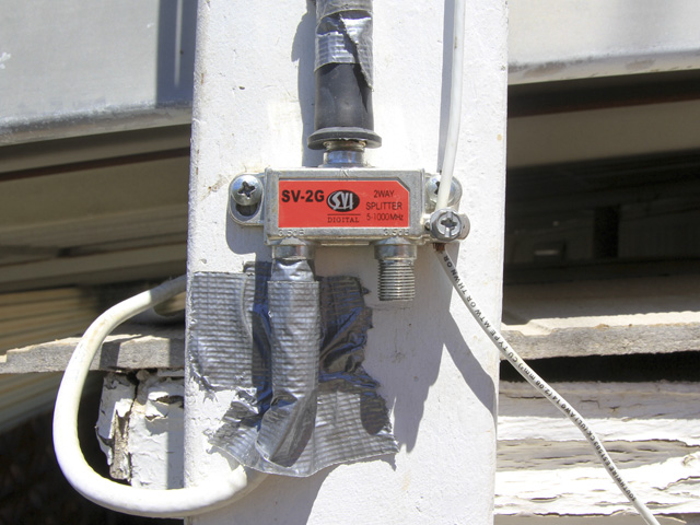

Are you using a 2-way splitter for a groundblock with one port unused? That gives a loss of about 3.5 dB. If you don't need the splitter there, then use a regular groundblock.
If you do need a splitter there, then it must be a powerpassing splitter for the preamp at the antenna.
Are you using a splitter to combine antenna and cable signals? That's not a good idea; use an A/B switch. The cable company and the FCC would not be happy that your antenna is radiating cable signals.
RG11 does have less loss than RG6, so it helps with long coax runs. With a preamp, it's overkill.

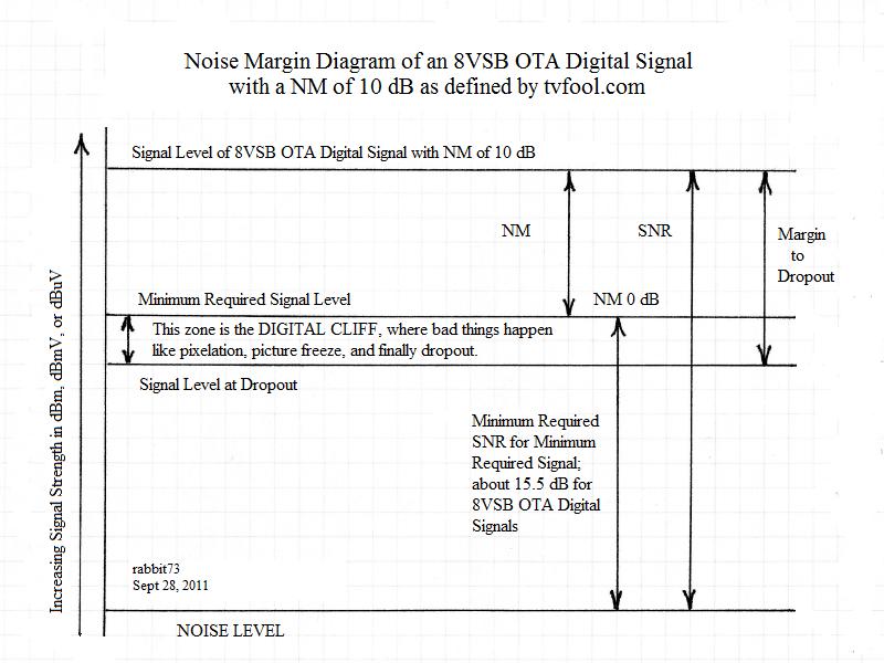

The AGC adjusts the gain of the tuner for the channel selected. The AGC is your friend because it adjusts the tuner gain to compensate for changes in signal strength.
With very weak signals, the AGC doesn't compensate because the tuner is being run at max gain. That is why you see intermittent pixelation and picture freeze when you are at the "digital cliff." See attachment #2 for my noise margin diagram, as defined by Andy Lee. Andy has an interesting post with two diagrams of signal reception and his explanation of Noise Margin:

I bought the ground block because it is what was on the rack at Fry's Electroincs. I rent from my landlord next door I may end up splitting the signal to them when they return in the fall.

Also your reply Rabbit reminded me that I did not mention that Accessing the inputs at the antenna is extremely difficult if not impossible. They are above the center of the carport roof, an aluminum siding type material that will not bear weight. I don't have a ladder that will get me to the 19'. I had thought I would connect the preamp just above the ground block using the 15' rg6 quad and then jump to the ground and complete the rest as needed. I figure that the rg6 quad should not lose much signal at all. Is this right in your opinion?
It's still not clear to me what you have there. There is no such thing as a groundblock splitter. A groundblock connects the coax shield to ground to satisfy the NEC for safety; it has very little loss. It is similar to an F81 coax coupler connected to ground. A conventional 2-way splitter can be used as a groundblock, but because the signal is divided in two there is a loss.
If you have a conventional splitter at that location just below the antenna it will not pass the DC power to the preamp. The coax between the preamp near the antenna and the power supply indoors carries the RF signal and the DC power at the same time. The DC goes up to the preamp and the signal comes down the coax to the power supply and then to the A/B switch and then to the TV. You need to replace it with a splitter that passes the DC power to the preamp in addition to splitting the signal in two. A conventional splitter will not pass the DC for the preamp.
For purposes of making a test with a preamp, I suggest you mount the preamp, without the splitter, as close to the antenna as you can without climbing; there will not be too much loss in the 15 feet of coax to make it worth the trouble of climbing.
antenna > 15 ft coax > preamp > real groundblock > coax to indoor power supply > power supply > A/B switch > TV

Re. "ground block splitter"
Most splitters include a connection for a ground lead and therefor can serve as a connection to the shield conductor for grounding purposes.
I would encourage anyone using a splitter in this manner to mount it adjacent to the electrical service ground, so as to minimize the length of the grounding conductor. Also, it's best to make the shield ground connection outside, before the coax enters the building, therefor all the connectors attached to such a splitter need to be waterproof.

You are great. Thanks for the input. I have attached a picture of my splitter ground block. I don't recall seeing the straight through ground at Fry's but have seen it elsewhere. Being at Fry's and thinking I might give feed to my landlord and emmm.... assuming that the connections for coax to grnd blks were basically the same I went with it. I can go out and grab the straight one thus eliminating some of that loss. Thank you Rabbit and Ground. Ground your comment about waterproofing is appreciated. My ground block is out doors right where the feed wire runs off through the car port at about 9' high. I have the wire attached to a 6" bolt connected to and sticking above my antenna run to and thru the block (by stripping 3/4" there) and then continuing on another 8' to a ground block on my service panel. Those are not water proofed so I thought I did not need to waterproof the antenna block.
