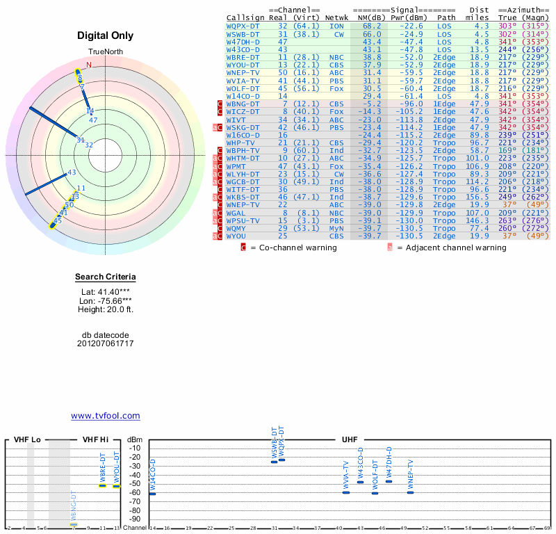

I just put up a new CM2020 to replace my old Rat-Shack UHF-VHF Yagi with a 120 " boom (not sure of the model) The CM2020 has about the same specs and the same signal issues. After pointing with a direct line in to TV (Sony Bravia) I have 88% signal on best channel (local wyou) and 80% on worst channel (local wolf). When I add the 4 way splitter and then the diplexors I drop down to 80% on strong signal and 72% on weak channel losing about 8%. This is causing more pixelation and audio drop outs and even a total loss of signal at my FTA sat receiver OTA imput. What would be my best bet for getting my signal loss back or even improving it.
The 4 way splitter is to give me OTA to my Sony TV, 2 satalite receivers with OTA imputs and my Sony AV system. Diplexors are Terk and RCA and splitter is Rat-Shack.
I do not know how to incert the link or image/plot I just saved but the channels I need most are local WOLF 56, WNEP 16, WYOU 22, WBRE 28.
PS Thanks thom, here is the link http://www.tvfool.com/modeling/tmp/9...getdigital.php

It would be helpfull if we had the report, but to answer your amplifier question, I need to assume that your diplexers are being used to combind your satellite and OTA. If so a good start would be to replace the four way splitter with a Channel Master CM3214 four way distribution. That will increase your levels throughout your system, and may be all you need.

Hope you all can see the report now. I have some answers but they may not be feasible. My splitter is outside. All lines in the apartment are thru diplexors due to the amount on equipment inside and the number of cables coming thru the wall. So sat feed and TV antenna feeds are combined from outside and seperated inside. I can't see how mixing the satalite LNB power and the TV distribution power will work. Maybe I am blinder than I thought or I didn't make this clear.
