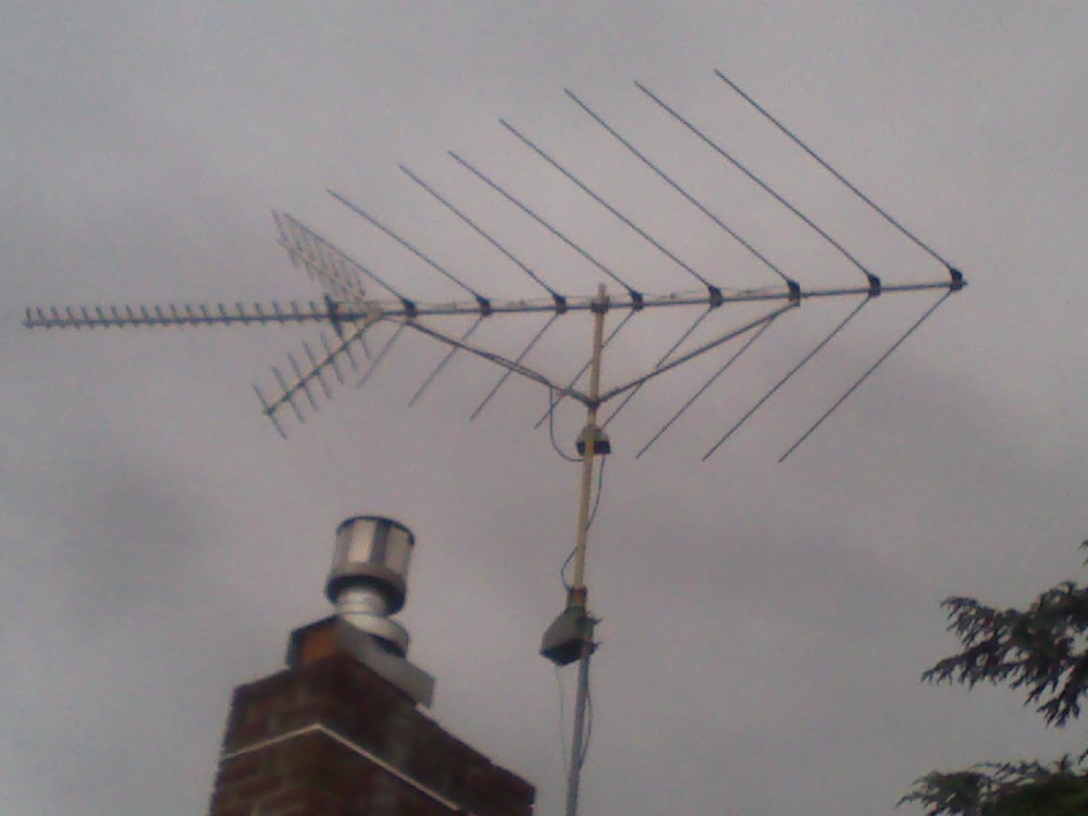

Hey all, I've been using the signal analysis here for quite some time to aim and find channels for my area, especially immediately around the pre and post switch to digital. But now I think i'm needing to get a new antenna - current on has bend and broken vanes. I'm about 55 miles from Seattle and 71 miles from Vancouver BC but primarily point to Seattle (tho' the Canadian Olympics coverage is great).
My current system: an old antenna ~10' on long axis (no brand/model name on it) I picked up on freecycle years ago (see attached pix) that is about 30' from ground attached to chimney; CM7777 pre-amp, CM rotor, ~30' cable (rg6u) w/ good rg6 compression f-connectors to inside pre-amp box; then a 2way splitter (& 5' and 10' cable) to 2 Vizio HDTVs.

The analog signal from CBUT on CH-2 has been shut down. If you're seeing their digital signal of real channel 43, there is no current or known future plan for stations to operate on real channels 2 through 6. So, a somewhat smaller antenna covering real channels 7 and higher would put less stress on the mast and rotator.
I'm thinking the Winegard HD7968P paired with an Antennas Direct CPA-19 preamp which can tolerate the strong signals from Mt. Constitution on Orcas Island.
I would also investigate the possible benefit of mounting higher.

Okay, is that 7698P, as that's what i could find at SolidSignal.
So, the biggest and longest vanes on a 'traditional' antenna are for the low VHF stations? As the 7698P appears quite streamlined - like eel-boned instead of flounder/herring-boned.

OOOPS! I transposed a couple of digits. Yes it's the HD7698P. http://www.winegarddirect.com/viewit...P%29&p=HD7698P
Take a look at push-up guyed masts... http://www.3starinc.com/telescoping_masts.html
(The lower the real channel number, the longer the element that is tuned to that frequency)
