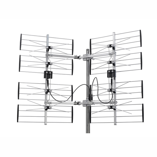

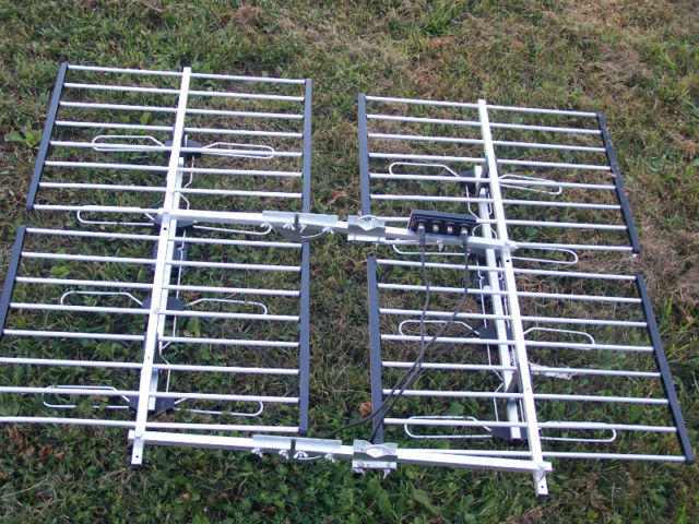

I have seen a few various designs of 8 bay constructions. and they all have various gain factors.
Some of the more common 8 bay have the driven elements that look like simple wires, basically the thickness of coat hangers (I say that loosely).
I see other driven elements that have a more flattened appearance and then I have seen other 8 bays that have the flattened loop appearance. Keep in mind that these are all new and not the home made versions.
Of course every manufacture will put its twist on design to make its claim of the better antenna.
But, what part of the antenna actually determines the overall gain.
1) the number of driven elements can certain be a factor but right now I am referring to 8 bays only.
2) the design of the driven element, Wire bowtie, flattened bowtie or flattened loop.
3) all the spacing involved where the driven element sits with respect to the reflector and distance between elements.
I'm sure some one might com back and suggest that all these factors play a part of the overall gain. BUT, are there any particular factors that make for a high gain antenna. At this point I am not referring to construction differences because we have seen cheaply built antennas and we have seen well built antennas and those have an affect on price.
No, right now I only question what determines the gain?

Craig: I can certainly understand that concept for any type of Yagi having various 'boom' lengths multiple directors, flat or corner reflectors. Or, for a log periodic or regular delta wave and simple dipole design
But for all these different and seemingly the same, 8 bay type antennas I see various styles of driven elements. Then we see on the advertising and/or the packaging where they claim various gain factors.
I suppose the question is: what determines the various gains on these 3 different types of driven elements "collectors". I'm only referring to the 8 bay flat bowtie shown in the pictures I submitted.
I also sense a lit bit of BS coming from the manufactures based on "under ideal conditions". When I say "BS" (carefully crafted words). I simply refer to claims 'the way they are written' in order to mislead the average person that has no RF background, Joe Average Consumer. Even legal beagles can't correct these claims unless they, too, have an RF background.
So, strictly on 8 bay reflector antennas, how do they determine the different gains, between brands for each 8-bay.
I can certainly understand and appreciate construction differences that would allow one antenna to be more durable than another and hold up to bad weather, hence they are built differently mechanically, But, when they all seemingly look alike with subtle differences, what changes the gain?

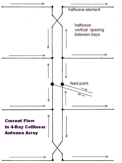

1) The number of elements is certainly the most important, but since you have limited your question to 8-bay collinear arrays (the proper name for the category), how you combine the two 4-bay arrays can affect the gain. If you combine the two 4-bays with a splitter in reverse, the maximum gain will be 2.5 dB; 3 dB for two 4-bays combined minus 0.5 dB combiner loss. There are other ways of combining two 4-bays that have lower loss if you are concerned about the last 0.1 dB.
Maximum combining gain will only be realized if the wavefront presented to the antenna is uniform and the plane of the antenna is perpendicular to the wavefront.
2) All those shapes will give the same gain at the design frequency if they are resonant at that frequency, but as you move away from the design frequency the gain curve will be different. The array will have less gain at frequencies below the design frequency and more gain above the design frequency, but "thin" elements will have a narrower bandwidth and "fat" elements will have wider bandwidth.
A collinear array has greater bandwidth than a yagi because it has a lower "Q," as defined by the max allowable SWR, and the fatter elements make the Q even lower.
Each bay consists of a collinear pair of half-wave dipoles that form a full-wave dipole. Each end of a half-wave dipole is a high impedance point, so where it connects to the vertical phasing line, the support point must be well insulated for low loss. Screwing the inner ends of the "whiskers" to wood can cost you 2 or 3 dB.
3) The spacing between the elements and the reflector is usually 0.2 to 0.25 wavelength at the design frequeny for max gain. A larger reflector can increase gain and so can a non-flat angled reflector.
The vertical spacing between the bays is usually 1/2 wave at the design frequency. When the antenna is operated at frequencies above the design frequency, the gain will increase because the vertical spacing and the elements become longer in terms of wavelength, with the max gain at 5/8 wave. As you move even higher in frequency the gain will decrease because the vertical spacing is more than when the capture areas of each bay just touch, and the element lengths are so long that the main lobe splits into two parts.
So, you can see that it is possible to construct an antenna for a specific frequency that puts the peak of the gain curve where you want it, which is not the same as the design frequency of an antenna that is for a whole band with the design frequency at the center of the band.
