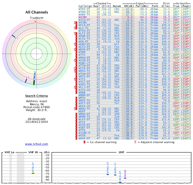

I live out in the sticks , and looking at my report I was wandering what if any antenna I could
Use to pick up some of the stations in Indianapolis.

Now my question is what model of antenna would give me the best possible chance of
receiving some of the Indy stations.
So far I am looking at the Denney's stacker antenna or the Channel master 3671.
Any suggestions would be greatly appreciated.

The Tv transmitters are Close at , 33.5 , 33.6 , 39.0 , 24.7 , miles.
The tvfool report you have posted is a Picture of a tvfool report.
Please make and post 3 Live and Active tvfool reports , not pictures of tvfool reports.
Post Live and Active reports at , 30 , 50 , 70 , feet antenna heights above ground.
A Live and Active 30 feet and At higher antenna heights , might show improved signal strengths , and change the 2 Edge Path Obstructions=hills/mountains , to 1 Edge or even LOS=Line Of Sight , receptions.
