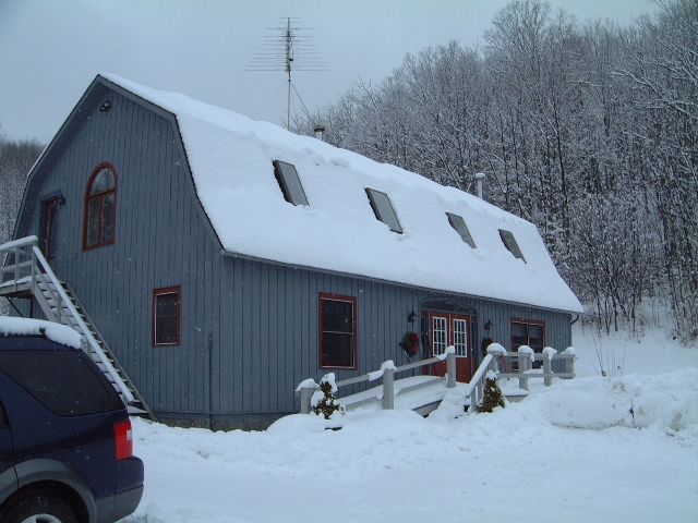

This house originally had a large roof antenna. Picture attached. Blew over 2 years ago. Hated the looks of it, but it did pick up the first 12 stations listed on the above report fairly well. Spoiled, but have to admit my reception usually better than these maps suggest.

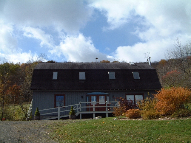

The house is fairly obvious on its hill location, so for aesthetics, had the antenna replaced with a shorter, narrower one, installed near a metal chimney. (Also, picture attached.) Chimney rarely used. Up until now, signal reception has been fine for my purposes. The new antenna does not pick up lo-V?, so the closest station suggested is not possible. Have regularly watched Channel 13 (IDed as “12” on the report), less so Channel 23.

Your new antenna is a UHF-only design. Generally, this is an ill-considered choice if reliable reception is expected of VHF stations. Given your description of the horse and the car, it's a common enough situation usually attributed to great intentions but a lack of technical detail. Please don't feel bad, it happens a lot.
Unfortunately, the Albany-Schenectady market is one of a relative few that REQUIRES an all channel antenna to ensure reception of the major local network broadcasts, the typical minimum requirement. Your CBS affiliate operates on low-VHF channel 6 while the Fox, NBC, & MyNetwork affiliates are on high-VHF channels 7-13. Ironically, your old antenna was the correct type for your market area.
Your recent reception success was probably an weather-related anomaly. Intermittently, a strong tropospheric duct can form that brings otherwise weak signals for a short time. the bast way i can describe it is to put into Start Trek - Deep Space Nine terms - a temporary, unstable wormhole type of effect. They come and go with the weather patterns.
Because of the sharp terrain blocking your immediate line of sight, you're likely going to be limited to VHF reception as those signals are able to "bend" (diffract) over terrain much more than will the UHF signals which will be much more line of sight proposition.
Unless you're willing to install a LARGE antenna, the odds of receiving the named stations are low. Depending on whether or not you're getting anything UHF off your UHF antenna will determine the path I'd suggest. If you're getting several of your other stations, ABC or PBS from Schenectady, for example, then I'd keep it and install a second channel 2-13 VHF-only antenna to try to pick up the missing VHF stations. I'd also suggest adding a dual-input pre-amplifier to perform the dual task of amplifying and combining the signals. We don't offer this particular antenna, but there are antennas available from either Winegard or Antennacraft that would work. Just be aware that the antenna is BIG. If you have sufficient room in the attic and do not have a metal or stone roof (or radiant barrier), then and attic mounting location *might* work well enough for you. Outdoors is strongly recommended if success is more important than aesthetics.

YES a very good reception situation , YES fortunately for you WRGB CBS is transmitting on VHF low band channel 6.
VHF low band channels 2 thru 6 , transmit a longer distance with less power over a greater area then the Tv channels VHF high band 7 thru 13 , UHF band channels 14 thru 51.
I recommend a Winegard HD7084P All channel antenna aimed at about 117 degree magnetic compass.
Install a Kitz Tech KT-200 remote power coax fed amplifier booster.

So the antenna is wired to a box in the loft, with wires continuing out to the house, that I am assuming is an amplifier? Then, I look closely at the antenna. Installer used some old ugly pole to put it on, and then it has wires running into another box, about 3x5x1 attached to the bottom of the pole. This included cable type wires, along with thin (electrical? ground?) wires going into the box, and back out. Seems to be not the best kind of situation for a VERY weather burdened area.
Yesterday at Thanksgiving, brother suggested maybe it is the amplifier. The antenna itself seems secure and directed as it was before. I'm now thinking some kind of equipment failure. I would be happy just getting back Channel 13, but not having to pay $100s just to tweak the one channel. And actually their chief engineer wrote me back in response to my wondering about their transmitter. Believe most Albany channels are on the same transmitter location. And 13 and 23 almost right next to each other. So probably at this end...
Would love to just find out what is no longer working at this end. Otherwise, I'm going for something large. I have no "attic", just 2 crawl space lofts at either end. Finished wood ceiling inside - not putting the antenna there! ;-) And the loft I believe too short to adequately stand/direct a larger antenna.
