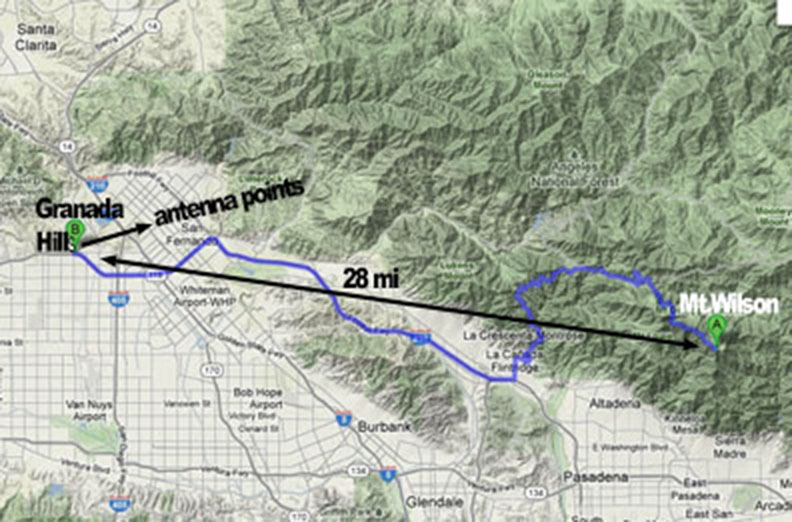

Will a stronger antenna help or hurt?
In the analysis
http://www.tvfool.com/?option=com_wr...267e94071d7e20
all the stations of interest to me are shown LOS from Mt. Wilson (where all the transmitters are). I can see it on a clear day east and slightly south, about 100 degrees, 25 miles away.
But pointing my antenna there, all the signals are too weak. We have to point our antenna east and slightly north, at about 70 degrees for usable signals. I think we're getting mostly bounce off the mountains rather than line of sight signal, or some combination. Apparently the analysis can't take this into account. I can't think of any other reasons.
Almost all the channels 2 through 62 are good. However, we're still getting dropouts on a few channels when atmospherics change with weather, like when we get very hot day. Rather than increased attenuation of a fixed path, this is probably due to the signal path changing. Then the apparent direction of the transmitter moves to the side of my antenna's beam, where the antenna's gain is less and the signal output diminishes.
The (virtual) channels that disappear frequently for long intervals are 22, 34, 52, 58. 58 is worst; KLCS (L.A. schools system) doesn't have the best equipment. I've heard that tuners have more trouble with its signals when they are weak. Channel 7 is odd because it fluctuates quickly while the others fade, even though the signal strength on the converter is at the low end of Good.
According to the analysis, 52 and 7 near the top of the list should be strong but but they're not adequate all the time. 58 is about halfway down the list, at the top of the red area, so it is definitely weak and comes and goes more often. I'm not interested in any of the stations further down in the red area.
I currently have Winegard's CA 7078 antenna and AP4700 amplifier, 4 way splitter, 75 to 100 ft of RG6 coax, 3 Digital Stream DTX 9950 digital converters, and a Samsung flat panel with built-in converter. Our antenna is 15 ft above our single story house, which puts it 35 ft above ground, just above the top of the hill across the street.
We need a stronger signal, so it would seem like a higher gain antenna is the obvious solution. However, a higher gain antenna would also have a narrower beamwidth. If the beamwidth of the new antenna is too narrow and the apparent direction of the transmitter shifts too much, it could even fall outside the antenna pattern. It looks like we're now pointing about 30 degrees north of line of sight. I can't guess how much the apparent position shifts with weather, but maybe you can. Probably not a lot, since only a few channels are affected. So, there's hope that the right combination of antenna gain and beamwidth could work.
The amplifier is making up for the transmission line loss of the cable and the splitter, and trying a stronger amplifier didn't help on the weakest channels. Clearly I need more signal output from the antenna.
Will any of the newer "digital TV" antennas solve the problem? Which one?
I've also thought about a really high gain antenna pointed LOS at 100 degrees, with a narrow enough beam to ignore the stronger signals at 80 degrees, but this sounds like fighting nature and doing it backwards. This would require a very large antenna, which would be a hazard in the high winds we experience here.

My first suspicion is that the AP4700 is overloaded. By turning away from Mt. Wilson you may be reducing the signal strength enough to get the AP4700 out of an overloaded condition. But now you are also aiming the antenna into some of the stronger multipath...
To test this theory, bypass the preamp (the mast mounted unit and the power insertion block) and any splitters using a known good coax directly from the antenna to one tuner that has signal metering. Now, starting with the antenna pointing straight at Mt Wilson, be sure to fine tune the aim of the antenna. Do you get a better signal?
I'm not convinced you need an amplifier at all. But if you do, it needs to be able to accommodate a large number of strong signals. If you have good signal from the antenna when feeding only one tuner and then loose some weaker signals after reinstalling the splitter, I'll be happy to suggest a high-input preamp or DA.
If you don't get a reliable signal at the antenna, an amplifier is not going to 'clean up' the poor signal. We would need to consider whether or not the existing antenna is damaged (another explanation for the aim point being displaced to the right of bore-sight), or do you need to consider a narrow beam-width antenna capable of rejecting multipath.

Sorry for the delay in responding. There are some very good reasons, but let's not clutter up this discussion.
I tested as you suggested. Components are all OK. One straight-in short coax with no splitter and no amplifier supplies most of the desired channels OK, but weak channels 22, 34, 52, 58. 58 (58 is worst) are still weak.
Also, I put a 3db attenuator in front of the amplifier and lost most of the good signals. It's a weak signal problem because of the 4-way split, not an amplifier overload. Note that the AP4700 amplifier is UHF only, to avoid overload by VHF in this area.
It's interesting that Ch 7 breaks up a lot when the 3 converter boxes' signal strength indicators are a little bit into the green whereas the other good channels work fine at that signal strength. Maybe interference? In addition, our Samsung flat panel TV (with an internal converter) has never responded to Ch 58 while the other converter boxes captured it OK. A Winegard consultant said that it has a poor internal converter that requires stronger signals in order to work properly. (Isn't that nice of Winegard to help out?)
Three months ago, pointing the antenna at 80 degrees was necessary because pointing at 100 degrees, straight at Mt. Wilson, was too weak for all the channels.
Weather conditions have changed substantially since then. Now I receive all the desired channels by pointing at almost 100 degrees, with the amplifier and 4 way splitter in place. This is still marginal because turning the antenna only +- 5 degrees loses the weakest, ch 58, even though the CA7078 antenna is pretty broad beam. Surprisingly, the Samsung is capturing Ch 58 now, for the first time. Signals are definitely stronger now.
This suggests that the multipath has shifted dramatically. Since I'm now pointing a little North of straight on to Mt. Wilson, I think I'm getting mainly direct and still a little multipath. Electron, you mentioned, "The Tv stations that are in the direction that you are receiving have a spread of about 25 degrees." But looking at Mt. Wilson from my house, all of it only looks like 10 degrees, which offers hope that a higher gain antenna might avert the multipath change that will surely recur when the weather changes again. If it's 25 degrees, it looks like I'm stuck.
Comments, please.

I gather the CA7078 has been in place for several years at this point? A small amount of corrosion, particularly at the connection between the antenna phasing lines and the matching transformer could produce low signal output, skewed pattern & intermittent symptoms affected by changes in temperature or humidity.
@Electron mentioned the Winegard HD7698P earlier, and in your situation it makes sense to consider using one. I honestly believe you should be able to gather enough signal out of the air... with no amplifier at all.
Before you do that though, a less expensive upgrade can be tried. Add an FM trap. You can find them at Radio Shack, Cat. No. 15-024. You may find it helps with real CH 7 and possibly others. It needs to install between the antenna and the preamp. (The second harmonic of KCRW-FM, 89.9MHz lands in the top end of real CH-7's bandwidth. {89.9 * 2 = 179.8}... Real CH-7 is 174 to 180 MHz.) If you replace the antenna, the addition of the FM trap is still prudent.

pointer , your core group of tv stations is from KVEA UHF channel 39 at 91 degree magnetic compass to KVMO UHF channel 23 at 113 degree magnetic compass.
A spread of about 22 degrees.
With the HD7698P antenna aimed at about 105 degrees magnetic compass the HD7698P antenna should also receive KWJD-LP UHF 22 or is it UHF 25 ??
