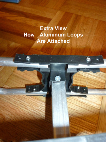

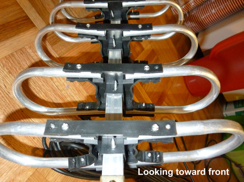

There are only three sizes of aluminum pipe loops. All the plastic parts that support the aluminum loops are identical for all three sizes. In my TRIAL assembly, I have only made the large loops touch [join]. The Large Loop is at the rear of the antenna.
I made only the large loops touch without any particular reason. For all the Small loops and the Medium loop, the 2 opposing aluminum pipe loops are not joined –they do not touch. These are about 2 inches apart.

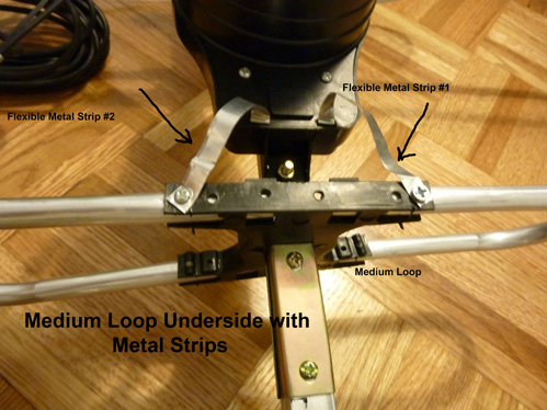

I guessed that the medium sized loop was the active part of the antenna and the others were reflectors. There were 2 thin flexible metal strips that came out of the center rotator assembly [black plastic marked UHF]. I attached one of each metal strip to each side of the aluminum loops. The two sides of this Medium Loop are not joined-they are not connected,

Which of the Small. Medium and Large Loops, if any, should touch in the center?
Should all the loops be isolated from the center square pipe?
If any of the loops need to be joined in the center [to form a closed loop] should I add a bit of wire to make sure they are well connected [joined in the center]?
Even when they are joined, they might separate a bit in the wind.
Should the metal strips be attached to the medium or to the large loop [I can do it either way ?

The only active element that I see is in the first photo, "...medium-loop-w-strips...".
I don't believe the left and right element sections are supposed to make contact with each other.

Yes the only element that I connected to the plastic housing [rotor] is the medium loop.
