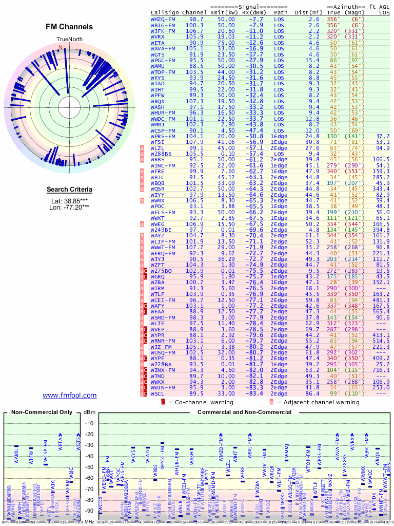

Originally Posted by staylor View Post
Channel 9-1 pixels in/out.
Perhaps the strong FM signals bother your TV. Consider trying an attenuator or a HLSJ to filter out the FM.

I think that Tower Guy hit it right on the head when he suggested some FM interference: channel 9.1 actually broadcasts on physical channel 9 in DC, and would be susceptible to FM overload with an antenna as powerful as the HD-7697P. A smaller antenna will not solve your problem, and would cause problems with the Baltimore channels.

Agree on the FM interference as well. An FM trap is necessary in much of Northern VA for reliable reception of WUSA-9 & WJZ-13. Connect the antenna to the IN/OUT terminal of the HLSJ & the HI terminal of the HLSJ to the TV. A terminator is generally recommended for the unused LO terminal, but I have never seen it make a difference.

In Annandale, the closest FMs are 106.7 and 105.9 (co-located with RF24), 98.7 and 100.3 from just outside Falls Church, and 105.1 and 90.9 from Arlington. As others have said, an FM trap is essential to clean things up.
