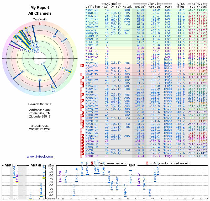

TV Signal Analysis Results: http://www.tvfool.com/?option=com_wr...0b865c9298b055
I can't view WMC TV 5 (5.1) with my indoor antenna, but I can view all other local channels with it. I have a TERK omni-directional amplified flat digital antenna but still can't pick up the channel. I've tried the standard rabbit ears antenna, but no luck.

The channel you are having trouble with is on VHF low which has quite long wavelength . To tune rabbit ears to that frequency pull them all the way out or to ~75 inches wide if yours even go that far. Try them straight out both ears horizontal, perpendicular to the station (north west of you).
Low VHF does not penetrate buildings as well as higher frequency signals and if you have foil backed insulation, aluminum siding or a radiant barrier then uhf signals may fit in a window and bounce to your antenna but channel 5 is 79 MHZ so waves are ~150 inches long vs ~19 inches for avg. uhf
In short you may need to get an antenna out side to get a clean signal.
Your local signals are strong so I wouldn't personally recommend amplified anything for you (IMHO amplified indoor antennas are of very limited use, that is almost but not quite useless)
A simple to make dipole or folded dipole cut to 37 3/8 " on each side total length ~74.75 " if put outside can be tucked under vinyl siding or otherwise hidden and added on to an indoor antenna. If you just want NBC

A outside roof top Winegard HD7000R antenna aimed at about 317 degree magnetic compass will lock in the reception of digital channel 5. Here is how to aim antennas , http://www.kyes.com/antenna/pointing/pointing.html. Here are some roof top antenna mounts , http://www.ronard.com/909911.html , http://www.ronard.com/34424560.html , http://www.ronard.com/ychim.html , http://www.ronard.com. Here are some places to buy antennas and etc. , http://www.winegarddirect.com , http://www.solidsignal.com , http://www.amazon.com , http://www.ramelectronics.net. To buy the ronard mounts from solidsignal , type the word - ronard - in the solidsignal search box or buy from ronard.
