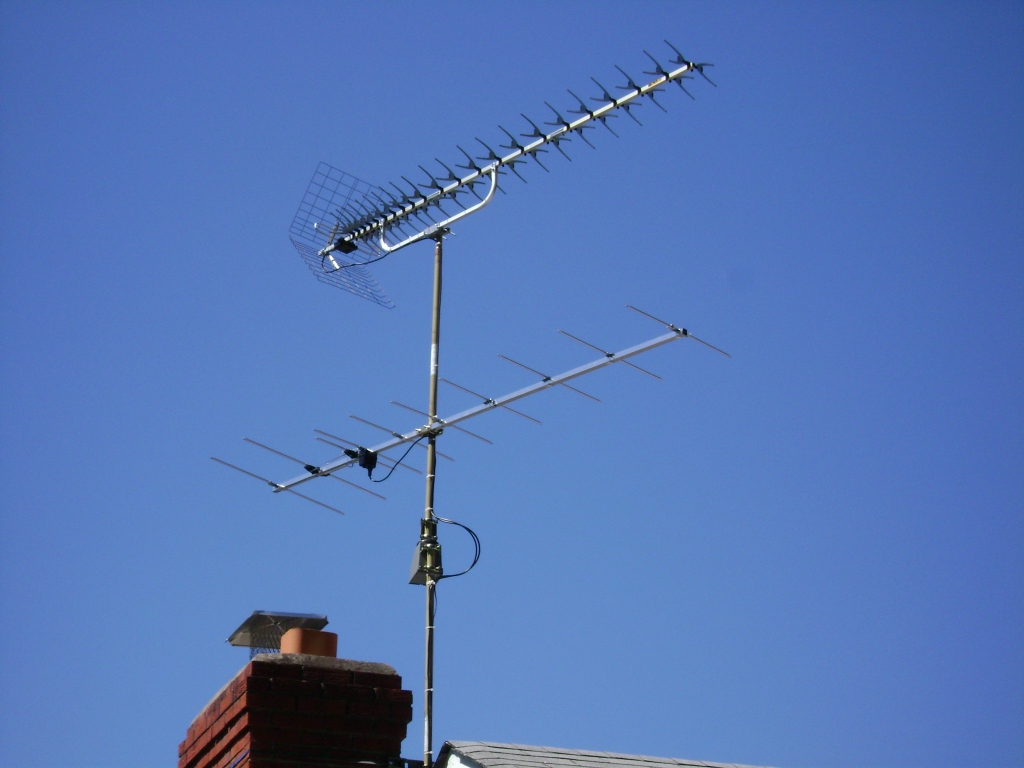

I haven't used any of the Eagle Aspen rotors, but my 9521 has fared well for almost 3.5 years with a higher than recommended load. Channel Master recommends no more than 3 feet of mast above the motor.
