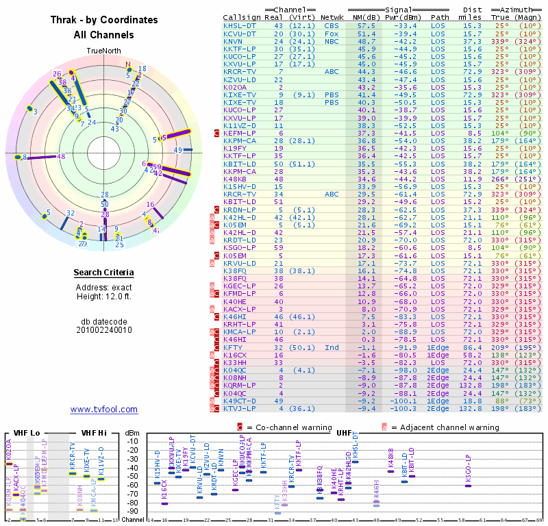

There's a J mount on the roof that holds the old dish and I'd like to simply remove the dish and mount an antenna there. I've looked online and just get more confused the more I look. I've considered getting the Antennas Direct DB4 or C4 but don't know if either of them is what I should really be looking at.
It seems that most antennas are listed as UHF only and there seem to be a number of VHF stations I would like to receive if possible. I'd prefer a single antenna solution. Any advice will be greatly appreciated.
http://www.tvfool.com/?option=com_wr...b7c8436fada7e6

You are really going to need a 2-antenna solution to see all your networks, but it isn't that difficult to make this work: your VHF stations lie in one direction, and your UHF stations lie in a different direction.
Use a Channel Master 4220 2-bay UHF antenna aimed at 8 degrees (due north of your location) mounted at the top of your mast for UHF, which will pull in CBS, NBC and FOX, and mount a Winegard YA-6713 four feet below the UHF antenna and aim that antenna at 310 degrees, as measured by your compass. This antenna will pick up ABC and PBS. Combine the signals from the two antennas into one cable using a Pico-Macom UVSJ antenna joiner, and run the cable to the antenna connector on our TV set. Be sure to ground your coaxial cable before bringing the cable inside your house: if you are using existing cable from your DirecTV installation, that cable is most likely already grounded. You will see all your major TV stations using that combination.

I posted this on another forum before reading Tigerbangs recommendation.
Plan on a rotor and a 7-69 antenna such as the HBU-22 or HD7694P.
OR
My preference would be a two or four bay UHF and a 5 element High band VHF with a UVSJ. (Channel Master 4220 HD with an Antennacraft Y5-7-13.)
Aim the 4220 between NBC and the other UHF stations. (roughly 5 degrees) The VHF yagi gets aimed at 323 degrees. The two antenna solution will be cheaper than a rotor and simpler to use. It's about the same size as a single antenna.
