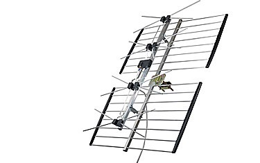

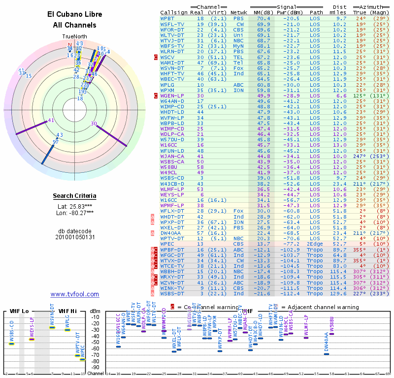

Recently I bougt an antenna 4241 HD Channel Master, but I want to get, obtain, or secure more amplification of the signal,
I have more than of 125 feet of cable
Asks: What type of pre-amplified I need to used?
I used:
1-CM4221HD Antenna
2-DigitalStream Converter
3-Distamp-25-GX (General Purpose Amplifier)
4- The Antenna is 15 Ft high

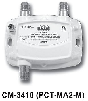

I think that the amplifier what I use is not the correct and
I'm trying to buy a new one, (CM3410)
Any suggestions welcome

Hello and welcome!
According to your tvfool report, your signal strengths are too strong to be handled by an amplifier. Just about any pre-amp you choose will overload with signals at this level.
You do not need amplification. You are only 12 miles from the transmitters, and even with 125 feet of cable, you should have plenty of signal with no amplification at all.
I used:
1-CM4221HD Antenna
Your antenna is fine. Just make sure it is pointed at a 28 degree compass heading. Do not use any amplifier of any kind. You should be able to get all the stations fine this way.
