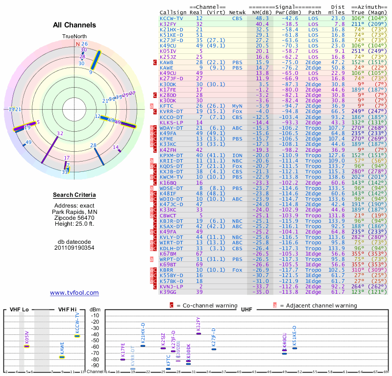

Hello. I'm trying to find out if it would be worthwhile to install an antenna at our cabin in N Minnesota. I've attached the report I received for my specific address. As we are only up to our place one weekend every 4 -5 weeks, it makes subscribing to dish service quite expensive. We are located in the woods so have to deal with that issue.

Like the other question askers do , Do This->http://forum.tvfool.com/showthread.php?t=4. Post a live radar report. The picture you took of the radar report is DEAD and we can not do any thing with it.

Sorry John.....I'm new to this site so didn't follow instructions as I should have. I hope this is the link you need: http://www.tvfool.com/?option=com_wr...60b58e397b29b5

One fixed aim antenna will not be able to provide full coverage of the available stations.
If you plan to watch different stations simultaneously you may want to consider installation of a separate rotatable antenna for each TV.
I would suggest you use a Winegard HD7698P and an Antennas Direct CPA-19 preamp. The 7698 lacks coverage of real channel 5 but K05IV appears to be an analog repeater for a FOX affiliate. Other stations such as K21HX also carry FOX programming. If you want to, you can add a single fixed aim low-VHF antenna. The signal would be easy to 'insert' into the rotating antenna feed (if you install an antenna for each TV, only one low-VHF would be needed, not one for each TV).

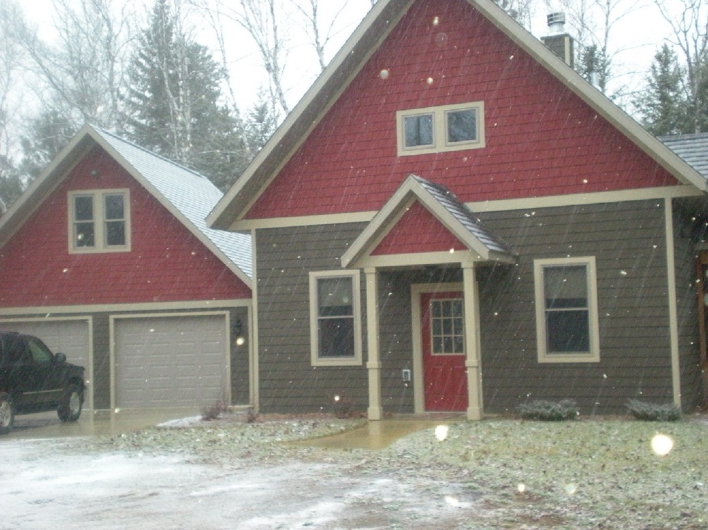

2) As I've never installed an antenna, can it be mounted on the rear of the house roof at the peak? The chimney is at the rear by the back edge. I've attached a picture to show both the cabin and garage.

Old 5-Oct-2011, 12:12 AM   #8
GroundUrMast
Moderator
GroundUrMast's Avatar
Join Date: Oct 2010
Posts: 4,773
According to http://www.rabbitears.info/market.ph...=K21HX#station yes, FOX, ABC. NBC and local weather are all carried. It would be reasonable to hope to see stations as weak as KFTC - MyN (At that level, 100% reliability may or may not happen, especially if there are trees to shoot through.) The stations higher on the list are within your reach.
Your roof looks like it would lend itself to using an Eave Mount. http://www.3starinc.com/adjustable_e...t_bracket.html
Your steep roof is not very inviting but he chimney itself looks like a good choice if you can access it safely. http://www.3starinc.com/ez29-36s_y_c...a_bracket.html or http://www.3starinc.com/ez30-6_tv_an..._standoff.html are potential solutions based on your photo.

I recommend a one antenna solution. A Antennas Direct C2V , UHF - VHf high band antenna , aimed at about 70 degree magnetic compass. Also a Antennas Direct CPA-19 preamp. http://www.antennasdirect.com. http://www.antennasdirect.com/store/...VHF-Combo.html Here is how to aim antennas , http://www.kyes.com/antenna/pointing/pointing.html. By googling the tv stations call letters as an example , like this -> k21hx tv , I found that k21hx tv has these digital sub channels , ABC , NBC , FOX. k51ke tv has weather and two local channels. k49cu tv has , FOX and My Network. kccw tv is CBS. kawe tv is http://en.wikipedia.org/wiki/KAWE . k27jf tv is NBC and a weather channel , This is a tv translator licensed to the city of Walker , the programing is KARE NBC , http://www.northpine.com/broadcast/m...anslators.html

I believe I will look at using the eave mount on the back side of the house. I should then look for a mast that would set the antenna 5 foot or so about the peak? I'm guessing the peak is roughly 25 foot off the ground as the interior vaulted ceiling is around 23 - 24'.

Hope to not overdue it here...but thought I'd add a couple of more pictures to try to show the trees we are dealing with at our location. My wife went camera happy this past weekend up there with all the colors changing!
As this is new to me, does the radar report allow for the terrain, etc in a specific area? I'm amazed at what info you can obtain on the web!

The radar report takes terrain into account, but not trees or buildings.
