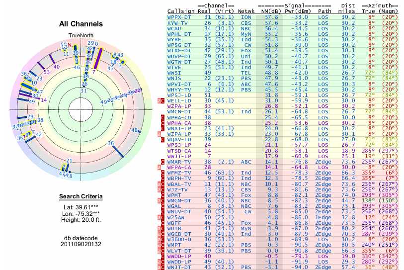

My large Radio Shack VU-210XR combo antenna at 25 feet up is pointing directly at my desired station (FOX, Philadelphia channel 29, actual channel 42, and a number of others; see attached tvfool signal analysis), but the foliage of a 70 foot tall oak tree is literally inches away from the tip of the antenna. It's up against the tree leaves and pointing into the tree. Channel Master 7777 preamp to deal with the 80 feet of RG-6 and splitter, though right now I've removed the splitter to try to help. No trace of a signal, either on my hdtv TV or a cheap digital/analog converter box, though I know I was able to receive this channel in the winter. I do get others from the same direction at this time, those ranked (by Noise Margin) numbers 2, 3, 4,and 5 in the tvfool analysis. In the winter I get a good bit more.

After seeing the chart, I'm now thinking the 7777 preamp may be overloading. Can you run the cable directly to one TV with both parts of the preamp removed? The 7777 preamp is designed for fringe areas & does not like strong signals.
