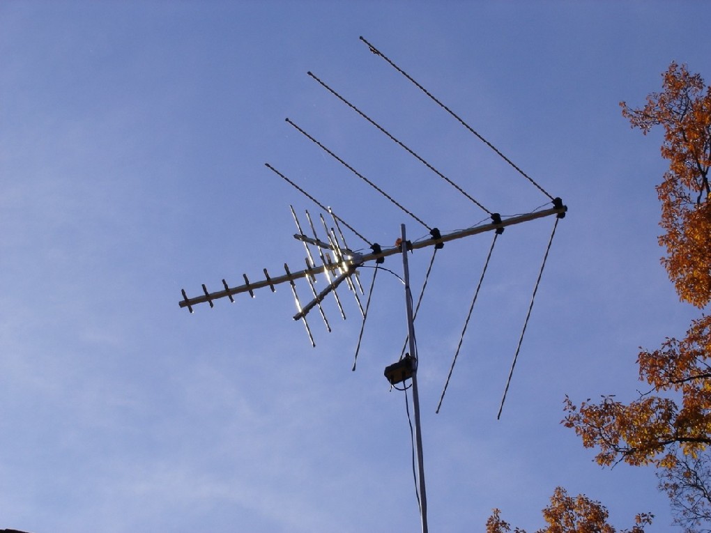

I'm located in Lake Neepaulin near the Sussex, NJ airport and watch New York City stations. Before the digital transition, I had acceptable reception with an attic antenna, although results seemed to worsen over the years (9/11?). After the transition, to see if I would get any signal at all before investing time and money, I temporarily mounted the same antenna (with converter) on the roof and got a few New York stations. In September I installed a permanent eave mount with this same antenna. I'm able to receive channels 2,4,5,9,11,13,31,41 and 68. Reception varies with the weather, but is acceptable on most channels most of the time. Traffic at the airport is infrequent and isn't a factor. I estimate that in general there is some pixilation/interruption about 10-15% of the time except for channel 7 which on rare occasions appears, but is not watchable and has no sound.
Here is a list of what I have installed:
1. Antenna – Radio Shack, Model? – Bought 17-18 years ago but in
excellent condition as it was in the attic.
2. Mast mounted amplifier – Antenna Craft Permacolor Model 10G212
3. Downlead – RG-6, RCA, 35 feet
4. Grounding Block – Radio Shack
5. Converter – Insignia, Model NS-DXA1
6. TV – Sony, Model KV27V36

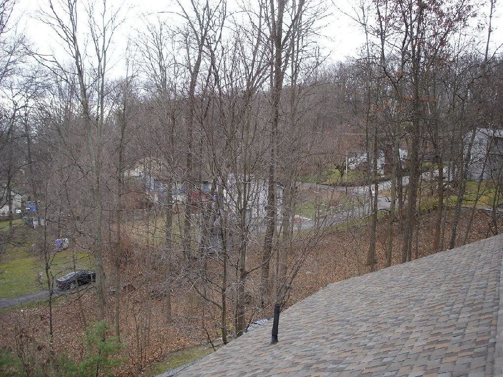

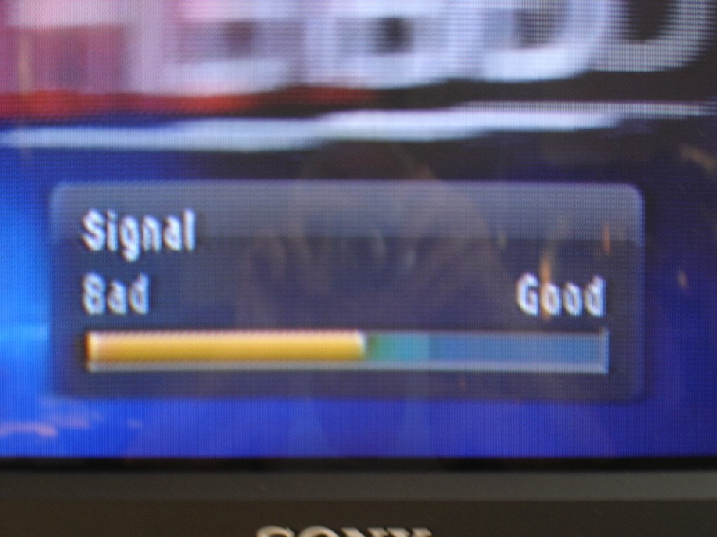

I’m also attaching pictures of the antenna, view from the antenna facing ~147° (NYC), and typical signal strength as shown by converter. When I installed the antenna there was about 50% foliage on the trees.

Just FYI, that's a picture of a Radio Shack VU-90 XR.

The VU-90 XR is an OK antenna. It's a relatively small full band antenna that does what it's supposed to. You are getting most of the channels that are within range of your location, but the problem is that it's not stable 100% of the time. This means that you could do better with some more signal margin to keep you off that "digital cliff". More margin will give you more room for variability caused by wind, trees, and weather that inevitably occur.
One way to get that extra margin is, of course, to get a bigger antenna. An antenna like the Winegard HD7084P or HD8200U will get you significantly more gain across the board and should give you much better stability on all your channels.
This amp has a Noise Figure pushing 3.5 to 4.0 dB, which is not quite as good as the 3.0 dB or less that you can get from the competition. The Antennacraft model 10G202 has better Noise Figure specs, and so do comparable offerings from Winegard and Channel Master.
However, switching to a better amp will only give you about a 1 dB improvement. This means that yes, it's possible to do better, but the gain is not very significant. I would recommend that you try a better antenna first. A big antenna will probably give you a ~5 dB improvement on most channels, and this will probably give you the added stability you need. If you still think you need that the extra 1 dB of improvement with a different amp, then you can always add it later.

If you gang antennas, you can almost gain 3 dB for every doubling of antennas. In all cases, you should only attempt this with identical antennas. Given the fact that you're starting with a VU-90 XR, you can gain a lot more than 3 dB from just a single antenna replacement.
I usually don't recommend resorting to multi-antenna arrays unless there are no other options. To do so requires learning a lot about constructing the mounts, connecting the phasing lines, and a whole slew of problems related to tuning everything.

The reason for the large antenna recommendations was because almost all of your channels are in the "red" zone and pretty weak. Smaller antennas might get you some channels, but the gamble is that you won't get channels further down the list or that the signals will be marginal (occasional pixellation and drop-outs).
