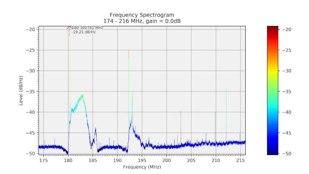

Yeah, I kinda had my eye on that one, but after running some scans, I'm not sure I need an omnidirectional antenna, but I'm thinking I can better point the antenna at K10PV-D (10), and/or get some better FM filtering and/or a get better VHF antenna.
I had forgotten there's a "backyard" FM radio station on 96.5. The station is operating at 0.1kw, but it's currently coming through my FM trap setup pretty strongly.
I went through all the UHF channels, most are coming in at 95%+ signal quality, with the exceptions of channel 26 at 76% signal quality and 32 at 69%, both lock just fine. Only one I can't receive is KSBB-CD (17), but only because it's an ATSC 3.0 stream.
I also recently learned KSBB-CD doesn't carry Fox or CBS any more, so I don't really care much for it.
For the VHF side of things, I'm unable to get the tuner to recognize 10, and while 8 is recognized, the signal quality is 44% and the tuner is not able to get a lock.
